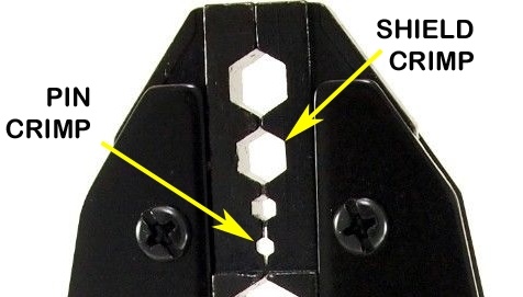

Question: What is one supposed to crimp those pins with?  The D-sub crimper?
www.avast.com [url=#DAB4FAD8-2DD7-40BB-A1B8-4E2AA1F9FDF2] [/url]
rick(at)beebe.org
PostPosted: Thu Jan 10, 2019 10:36 am    Post subject: Building Coax Reply with quote
There is, of course, a specialty crimper. The ratchet crimper I have has small holes for crimping the pin and then a larger hole to crimp the ferrule. Something like https://tinyurl.com/y7tv4jzl
--Rick

PostPosted: Thu Jan 10, 2019 10:57 am    Post subject: Building Coax Reply with quote
At 11:42 AM 1/10/2019, you wrote:
On 1/10/2019 9:30 AM, Valovich, Paul wrote:
When building a coax cable can I use a male D-sub pin instead of the pin supplied in the connector bag?
Tried to crimp those pins with a D-sub crimper and it didn’t go well. I now have extra connectors with no pins.
I had a similar situation. I substituted a D-sub pin and it seems to have worked well.
With that said, I'm ordering some extra pins for my remaining orphan plugs per Bob's post.
The tool you crimped the hex-sleeve should
have a die for pins
[img]cid:7.1.0.9.0.20190110124906.05e98e10(at)aeroelectric.com.0[/img]
See https://tinyurl.com/y7to3wnb
