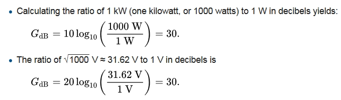

It's an old wive's tale that a 40 dB gain is 40/3 = 13 times power gain over 0 dB.
The decibel is a ratio of two physical properties expressed mathematically using logarithmic base 10.  When referring to power, below are the calculated values using the equation dB = 10xLog10(P/Po):
0 dB = 1
3 dB = 1.995 = ~2
  6 dB = 3.981 = ~4
9 dB = 7.95 = ~8
10 dB = 10.0
20 dB = 100.0
30 dB = 1000.0
40 dB = 10,000.0
So 40 DB represents a ratio of 10,000, not 13. If 0 dB = 1 milliWatt, then 40 dB = 10 Watts.

40dB is 40/3 = 13.3 doublings, or a ratio of 2^13.3, which is about 10,000, as you say.

Alec:
I did say "Rule of Thumb".  I did not look up if the dB gain expressed in the manual is voltage or power, but I'm pretty sure it would be voltage.  And the rule of thumb is the voltage signal will double with every 3 dB of gain.  Ya got me...  I did not sit down with my slide rule and work out the voltage gain, I am  just trying to show a relative number that non engineers can work with.
But, your numbers are incorrect.  A 10,000:1 dB ratio gain would be more like 80 dB's not 40 dB's.
See: Common Gains and Losses Expressed in Decibels
http://www.sengpielaudio.com/calculator-FactorRatioLevelDecibel.htm
Barry
On Sat, Dec 22, 2018 at 11:31 PM Alec Myers <alec(at)alecmyers.com (alec(at)alecmyers.com)> wrote:
On Dec 22, 2018, at 21:10, Henador Titzoff <henador_titzoff(at)yahoo.com (henador_titzoff(at)yahoo.com)> wrote:
    0 dB = 1
    3 dB = 1.995 = ~2
    6 dB = 3.981 = ~4
    9 dB = 7.95  = ~8
  10 dB = 10.0
  20 dB = 100.0
  30 dB = 1000.0
  40 dB = 10,000.0

3dB is a doubling of whatever you measure. (Actually a factor of 10^0.3 = 1.995)
Of course you have to say what you’re comparing with, so we talk about dBA, dBV, dBm, for sound level relative to the quietest detectable by the human ear, volts, or power (in mW), respectively.
If you’re talking about Voltage then 40dB is by definition a ratio of 10,000 to 1. Which, into the same load impedance corresponds to a power ratio of 10^8 to 1.
0 dB = 1
3 dB = 1.995 = ~2
6 dB = 3.981 = ~4
  9 dB = 7.95 = ~8
10 dB = 10.0
20 dB = 100.0
30 dB = 1000.0
  40 dB = 10,000.0
Everything else you say below is correct except that RF engineers, as well as LiDAR engineers, refer to too much signal as saturation, not splatter. Maybe I'm hanging out with a different bunch of engineers, but we use what the literature says.
I see this is actually true only for power quantities and power-like quantities. For field quantities and field-like quantities 3dB is a ratio of 10^0.15 = 1.41. So a signal ratio of 40dB is ten thousand times the power and 100 times the voltage.
That’s what you get when you put the engineers in charge of defining units instead of the physicists.
The Bel (or its smaller descendant deciBel) was
derived from concepts in physics. . . as were
many other dimensionless numbers that described
RATIOS of many quantities that do have dimensions.
Look up dimensionless physical constants like
proton to electron mass ratio, Plank's constant,
Coulomb's constant, etc.
Then there are ratios near and dear to aviation
like Mach number, Reynolds number, strain,
and yes . . . even deciBels. The Bel is
always about energy ratios but is still
valid for discussion power. While power
is a rate function, it is proportional to energy
when the rates are defined over the same intervals
of time.
It is proper to discuss ratios of power (like
watts) and amplitudes (like voltage, amps) in
terms of dB if one compensates for the effects of
amplitude on power in the system. This is
accomplished with application of formula
that accounts for the square law effects
of amplitude on power. Hence the constant
for "deci" (10) has to be doubled to 20
when considering ratios of amplitude.
[img]cid:.0[/img]
This was no shortcoming on the part of
engineers vs. physicists . . . they've
all been on the same page since day-one.
