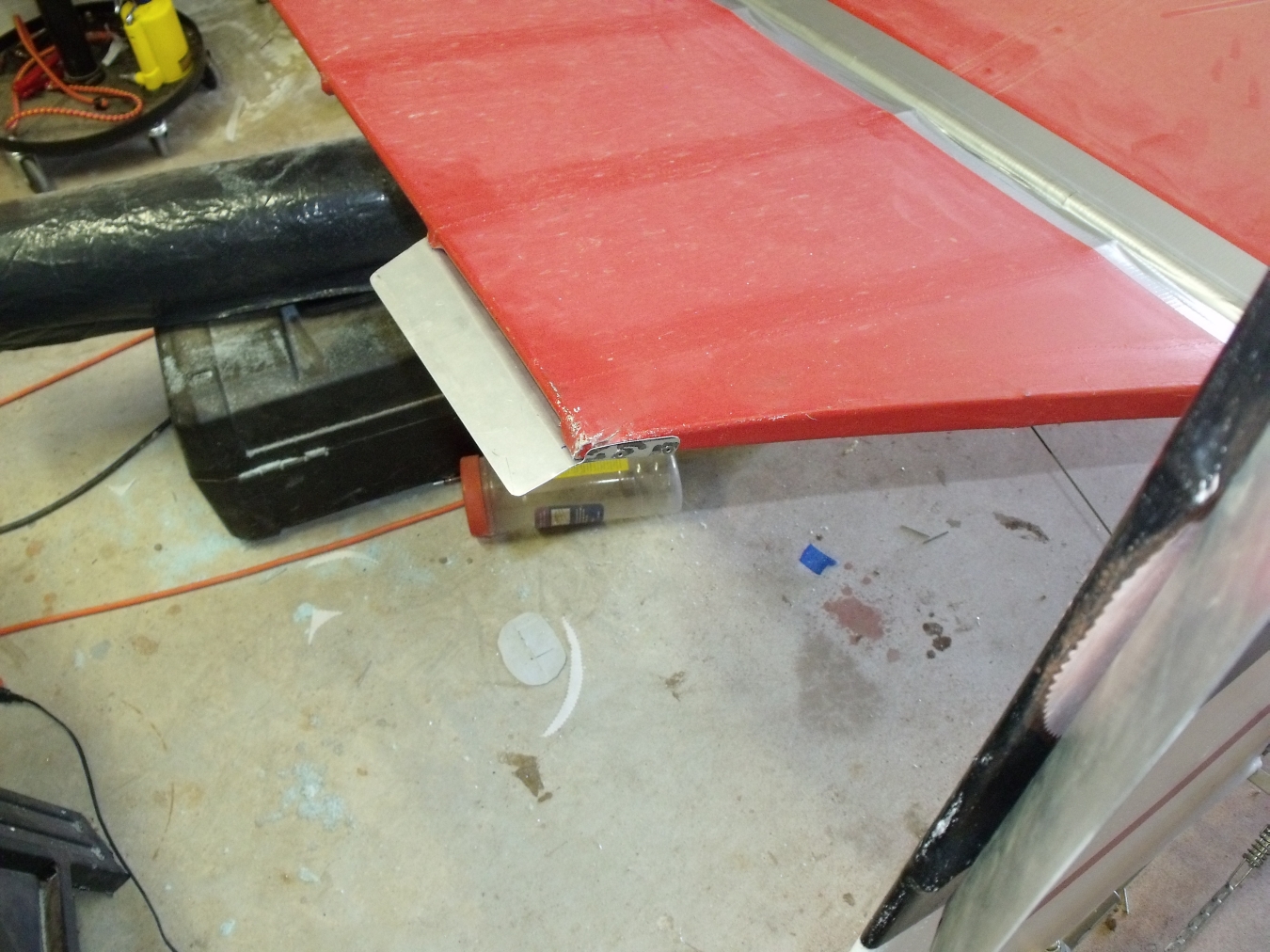

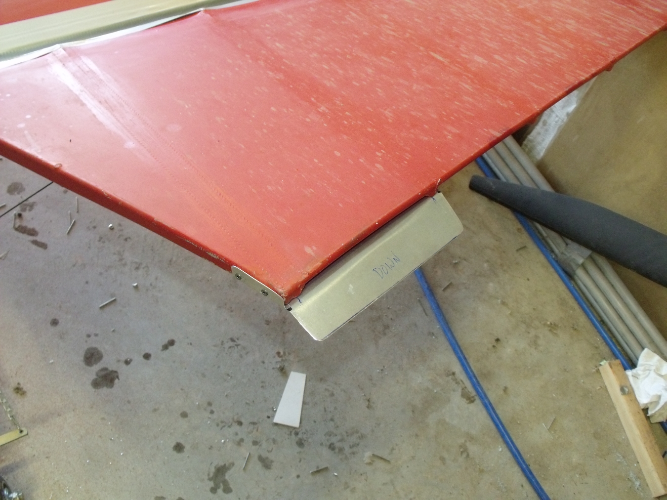

PostPosted: Mon Nov 05, 2018 8:10 pm    Post subject: HKS / Firestar STATIC THRUST test Reply with quote
Bill, Did you ever put trim tabs on your elevators? I went through all the emails I'd saved up since last August when this thread started and I didn't find anything from you on trim tabs other than you believed they'd have to be big with a big deflection. Attached are pictures of the trim tabs I added to the Mk IIIX to fix its lawn dart tendency. They were actually a bit too much for flying solo, but just a tad and since the owner intended to use the airplane for his personal flight training I left them that way. Even so it only took a two finger grip and light pressure to keep the airplane flying straight and level.   I'm going from memory as I never made a drawing of them but the deflected portion was about 6" X 1.5" and bent about 20 degrees.The small amount that they moved the elevator made no discernible difference to cruise speed.
Rick
