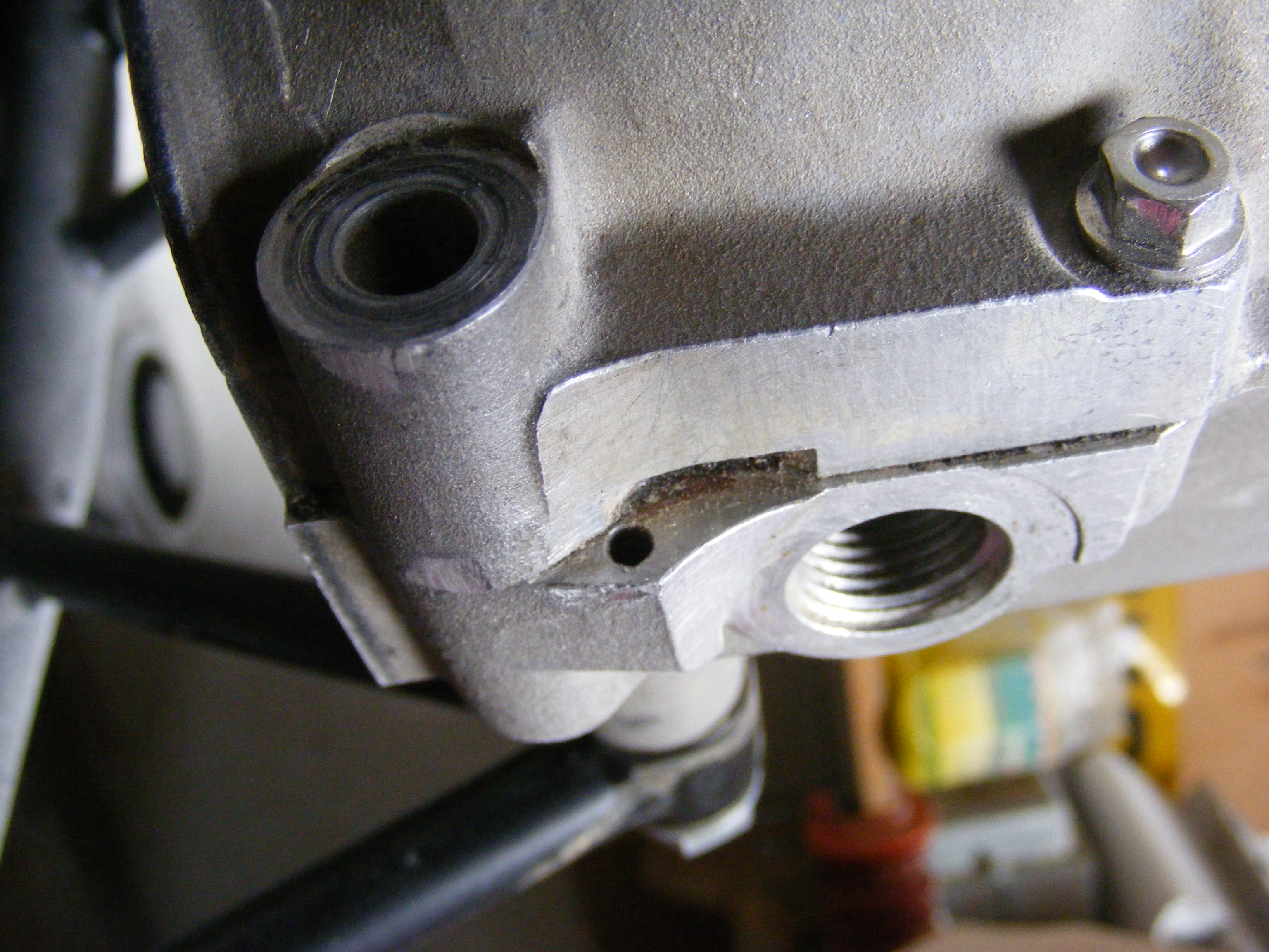

PostPosted: Mon Nov 19, 2018 3:35 am    Post subject: Re: lock-wiring 912 sump banjo bolt Reply with quote
Richard is correct - in fact there are two holes !
 Filesize:  1.52 MB
 Viewed:  8254 Time(s)

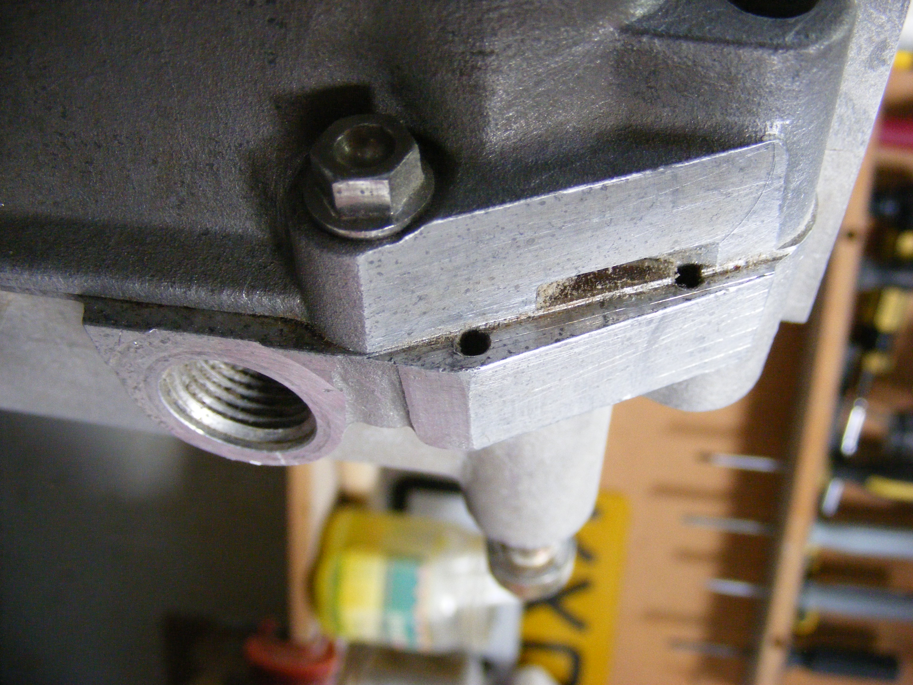

PostPosted: Mon Nov 19, 2018 3:52 am    Post subject: Re: lock-wiring 912 sump banjo bolt Reply with quote
........................at the front, and one at the rear.
.... good recovery I thought Wink
 Filesize:  1.5 MB
 Viewed:  8242 Time(s)
