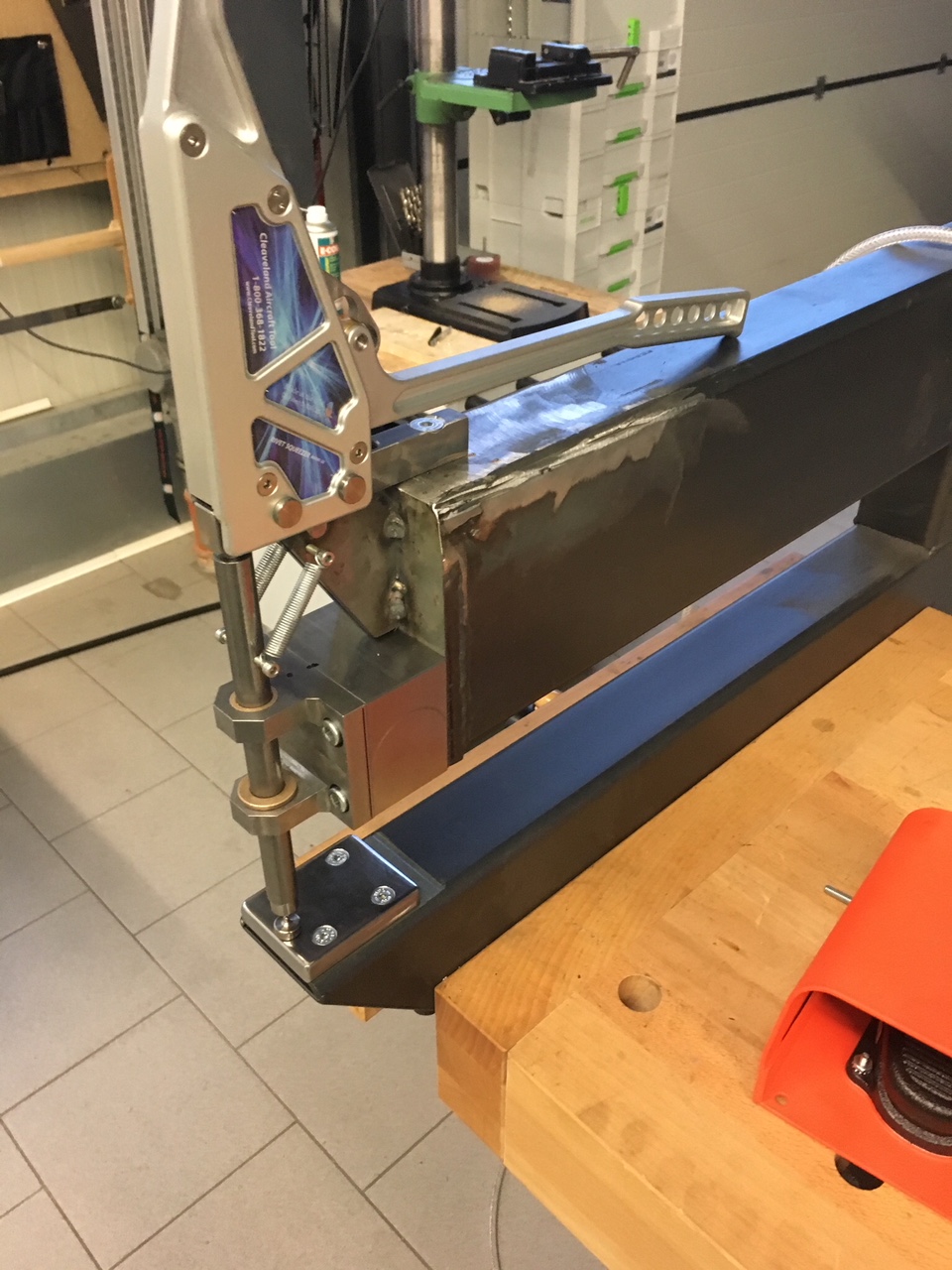

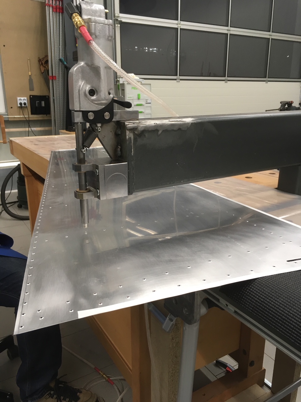

Hi guys,
I did a frame myself welding the quarter pipes and made a bracket which has the same two holes, that are in the jokes for the manual and pneumatic squeezer.
Did cost 90€ steel pipe, some work on the lathe and the milling mashine Surprised)
Made the arms a little longer to reach all down to the stabilizer leading edge....
[img]cid:94B98672-B44A-4273-A743-632A21F947B2[/img]
[img]cid:C7C33666-3277-4756-B8FC-EA17DEEF3AFD[/img]
[img]cid:280F3EDC-C64D-450D-B846-3521AC09A7AA[/img]
The bottom plate is normal steel, sanded and polished shiny, then put some car wax for protection.

I did my entire build with a pneumatic squeezer and occasionally
borrowed a hand squeezer. In retrospect, I would spend less on the
pneumatic by getting a used or rebuilt one from Brown or others, and get
a good hand squeezer that uses the same yokes. A hand squeezer has much
better control and finesse, while the pneumatic is better for multiple
rivets. The DRDT-2 is a fantastic tool, especially if building at home
and not wanting the noise of hammering on a C-frame.
