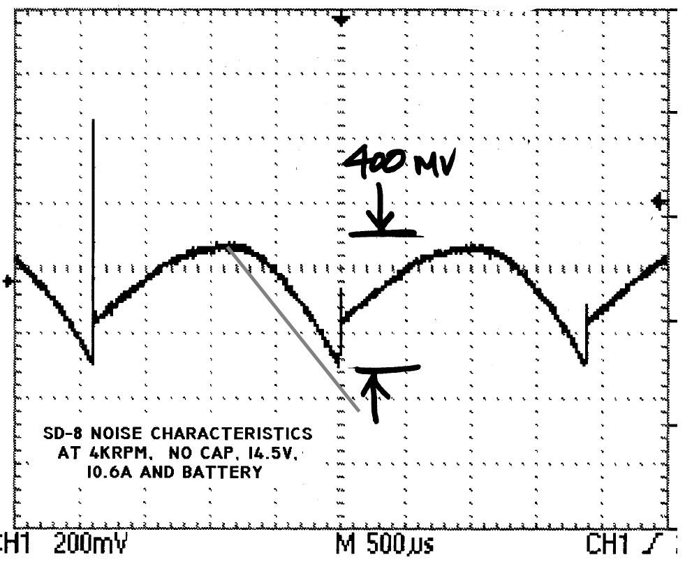

Here's a family of plots I took on an SD8 alterantor
on B&C's drive stand about 15 years ago:
https://tinyurl.com/cz7ekrf
Page 1 is a picture of a fully loaded SD8 with
capacitor installed. Measured noise in the low
frequency spectrum was about 250 millivolts peak
to peak, 77 mV RMS.
Page 2 shows what happens when the capacitor is
removed . . . 760 mV pk-pk and 72 mV RMS.
In other words, no significant change. Alternator
noise on the bus in an airplane with a wound field
is MUCH higher and broader spectrum . . . but still
nothing that your electro-whizzies should care about.
I fiddled with some no battery ops too on pages 7, 8 and
9 . . . but didn't see how it performed with no capacitor.
I'm thinking that planning for no battery ops is a
capitulation to poor battery maintenance practices
and/or errors of conducting FMEA in deciding architecture.
Short answer is I don't think the capacitor adds
any useful benefit. If anyone runs across some testing
data that contradicts these findings, I'd be delighted
to know about it.

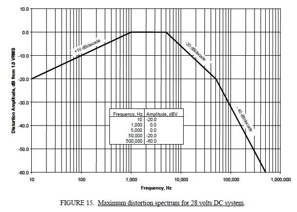

I was pretty stunned with that realization . . .
and embarrassed that a MIL-STD-704 knowledge-nugget
I'd worked with for decades was telling me the same
thing . . .
[img]cid:.0[/img]
Noise levels to be EXPECTED in a normally operating
28VDC system over the range of 1000 to 5000 Hz were
1.0VRMS or 2.8V pk-pk . . . with fall-offs at
each end. In other words, as a normal state of
affairs, pk-pk noise can be as much as 10% of
system voltages.
We know that batteries stand off LARGE perturbations
above 13.5 and below 12.5 but that would hardly
qualify as a 'filtering' function.

I wonder if that capacitor is an artifact from back when PM alternators were operated in vehicles that were designed with no battery. Not unlike the avionics master as a holdover from the prehistoric germanium semiconductor days.
Charlie
An excellent hypothesis . . . but it seems
it equally likely that somebody looked at that
full wave rectifier downstream of an AC
source and thought, "Gee, every circuit like
that in the past has had a capacitor across
the output . . . shucks . . . why not?"
Let's noodle some of the math that helps
us figure out just how effective a capacitor
might be for 'filtering' a PM alternator system:
A fundamental quality of capacitors is described
by this formula:
Volts/Second = Amps/Farad
meaning that if you apply 1 amp of constant
current to a 1 Farad capacitor, you'll see
voltage across the capacitor rise at a rate
of 1 Volt per Second.
How rapidly will the voltage change
across at 22,000uF capacitor in a
PM alternator system with 10A load
assuming the positive excursion has just
charged the capacitor to the expected peak
voltage?
V/S = 10/0.022 = 454 Volts/Second or let's
say about 500 mVolts/mSecond.
Adding a 500 mV/mS plot to the no-capacitor
plot of SD8 performance we see
[img]cid:.0[/img]
By inspection we can deduce that the addition of
22KuF to the output would have no appreciable effect
on the voltage plot shown. If we put a 47KuF cap
on it (less than 1/2 the slope) we might see a reduction
in pk-pk excursion to something on the order of 200mV
. . . but why bother? We know that appliances qualified to run
in aircraft EXPECT to see noises equal to or perhaps
greater than what's depicted above with no capacitor.
I might also add that automotive electrical systems
are completely devoid of electrical system noise
filters that address the spectrum of alternator
ripple and switching.
So if there is a reason based on physics for adding
capacitors to the PM alternators, it's not intuitively
clear.
