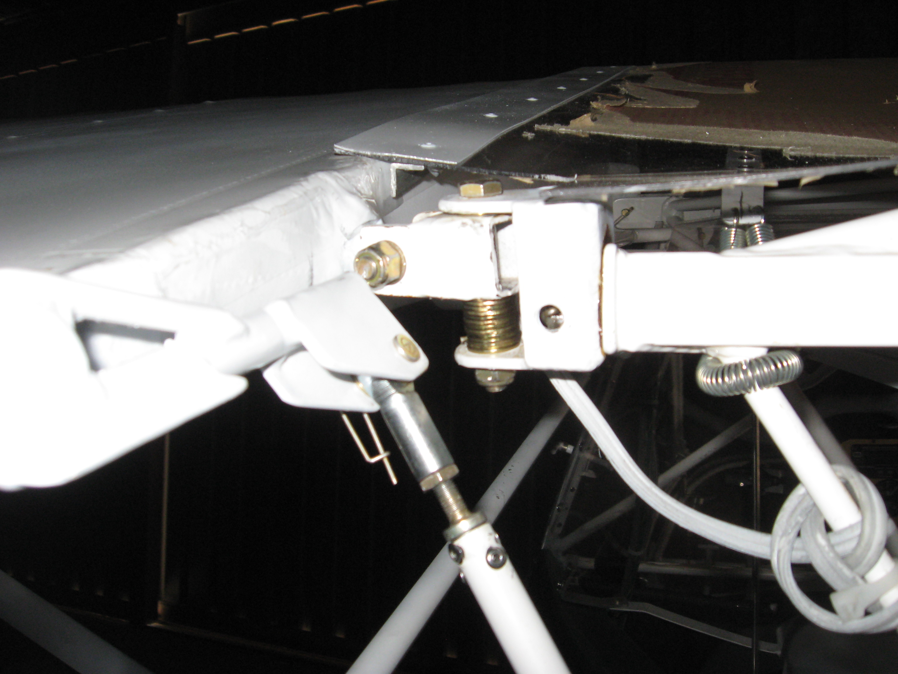

PostPosted: Mon Aug 13, 2018 9:17 am    Post subject: Re: Kolb-List:Stabilizer Angle Reply with quote
Hello Bill/Kolbers,
I have been following this thread from the beginning.
When I saw your photos I was reminded of my MkIII Xtra where I had followed the factory instructions and later had to adjust the front mount of the Horizontal Stabs to be level with the top of the Boom tube. But not as high as yours.
I also got a set of the wider universal joints to raise the Trailing edge of the wings about 1inch.
Your wings look like they are set at a very high angle (Yes , your wheels make it look high) and your Horz Stabs are not far from that same angle.
As well as checking your CG, I would also verify the Angle of attack of your wings and how your tail should be in relation to your wing on any plans you have . I believe your elevator should be producing a down force that counters the high engine thrust line. See the attached photo of the wide universal joint KOLB made for me.
FrankD

PostPosted: Mon Aug 13, 2018 1:47 pm    Post subject: Re: Kolb-List:Stabilizer Angle Reply with quote
Even though Frankd does not have Image Resizer (poor chap - blew the page dimensions all to pot wit da giant pitchur) https://www.bricelam.net/ImageResizer/
he does bring up a good point: if your wing and your horizontal stab have the wrong angle between them, it causes problems.
There is an app for Android phones called "Bubble Level" - it seems to be accurate to 1/10 of a degree.
Went out and checked my MKIII; stab leading edge bracket is right to plans, main spar attach point is right to plans.
The underside of the wing measured along a rib bottom was at an angle of 8.3 degrees.
The root tube of the horizontal stab was at .3 degrees.
Exactly 8 degrees of difference between the bottom of the wing and the horizontal stab.
Don't know if that is what it is supposed to be, but my MKIII has always been easy to fly, trim, etc. At least it is known to behave acceptably, which gives us all something to work from.
Worth what ya paid fer it.
So Brother Berle - How about you download Bubble Level onto your smart phone, go check your wing and tail, and let us know what ya got.
Richard Pike
