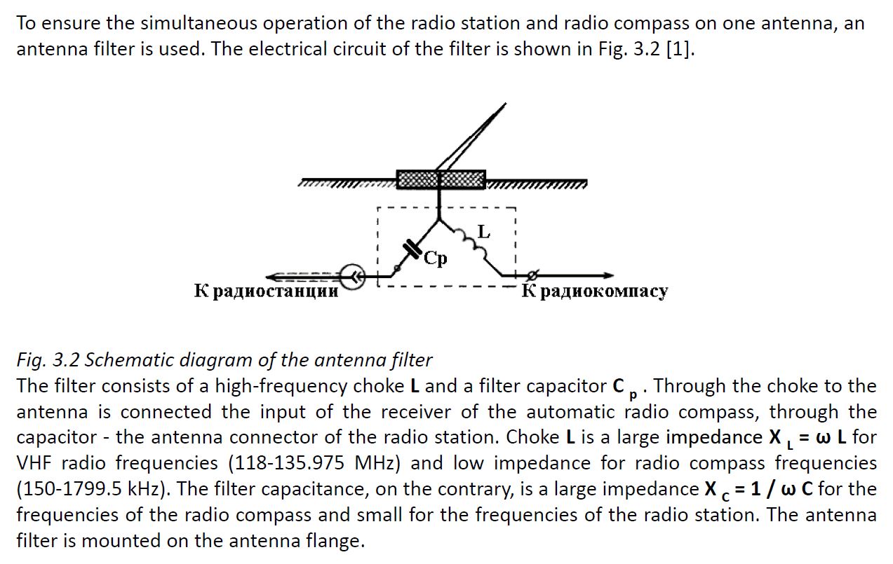

Mark & Jan, thanks for your kind words & for the record "Я не говорю и не читаю ру��кий" ... but latterly Goggle translate is my friend and before that OCR / translation software Smile
Over the last decade I've re-drawn all the wiring diagrams by hand having reverse engineered all the originally supplied schematics and researched the key devices to find out how they work.
Hence our free ranging discussions over the years on voltage regulation, fuel displays and 'shower of sparks'!
The work continues and only recently have I gained an understanding of how the stabilising transformer helps manage voltage regulation on high current load transitions and why Baklan replacement radios appear to work better with the original antenna than new ones.
On that topic ... the original antenna has a crude 1st order RC high pass filter / splitter at the base of the antenna for the radio feed, and an LR low pass to the ADF sense feed, so the bulk of square wave ignition noise harmonic energy is filtered before it gets to the radio RF stage.
As radio is more your area of expertise than mine Mark I'd welcome your thoughts on finding a higher order in-line high pass filter suitable for a transceiver to work with replacement antennas.

PostPosted: Fri Jul 13, 2018 4:57 am    Post subject: Re: [Non-DoD Source] Re: Circuit breaker size for pitot hea Reply with quote
Mark,
Thanks for your useful insight as always ... I don't have an original antenna to inspect, short of stripping the one out of my aircraft, and neither the analyser kit even if I did. So if you have an original antenna to hand and an analyser that would be very helpful to better understand empirically what is actually going on.
As you point out this was designed as a 'splitter' and not for the purpose of reducing RF interference into the original Baklan radios. But from practical experience (identical kit installs, by 40+ year avionics guy with same loom design and materials) it does appear to help some newer 8.33k replacement radios that are more sensitive to RFI.
I agree from Fourier principles the square wave RFI 'hash' will run across the band at odd harmonics that rapidly diminish in magnitude with increasing frequency, hence the high pass takes most of the lower frequency 'energy' out that probably helps the RF amp from being overwhelmed by transients. The original Baklan radios may not have needed this, but replacement radios seem to find it beneficial.
The attached schematic (extracted from a Russian doc) shows how simple the circuit is, that relies on the RF cable impedance to provide the 'R' component of the filters. Annoyingly no component values are given, nor on the original schematics, where it just refers to it as being factory manufactured, so custom made.
Given this is only a first order filter the roll-off slope is gentle, and to avoid attenuating the aircraft comms band, the Fc might be as low as 30Mhz. It will be interesting to see what your analyser results yield.
Hence finding a higher-order in-line diplexer alternative, as you've come up with, could be a big help and as I don't have the kit, or radio expertise, to provide definitive answers I really value your skills here.
Rob
