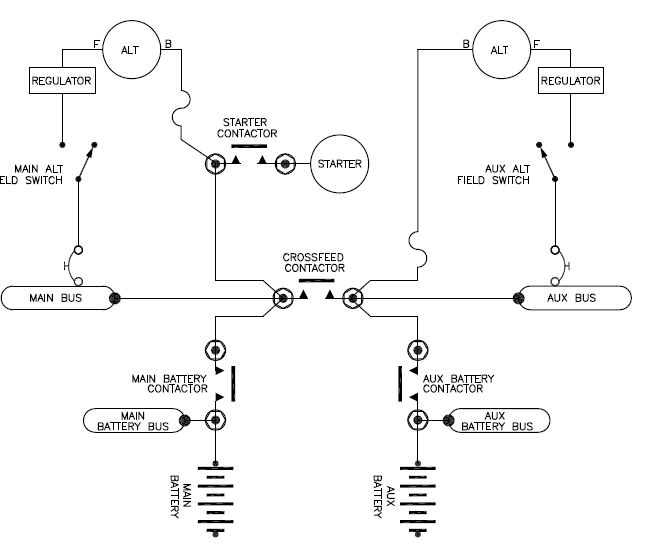

If you "solve" the "problem" by moving the alternator feed wire to the battery side of the contactor, then you create a separate problem (one many would consider more serious) in that you will have nullified the ability to cut off all current by simply moving the master switch.
On Wed, Jul 11, 2018 at 7:40 AM BMC_Dave <bmcdave85(at)gmail.com (bmcdave85(at)gmail.com)> wrote:
--> AeroElectric-List message posted by: "BMC_Dave" <bmcdave85(at)gmail.com (bmcdave85(at)gmail.com)>
It almost feels like I'm being intentionally gaslit, I'll try again. We're addressing the OPs use of Z14 and his concern about why the alternator isn't on the battery bus side of the contactor. Additionally, the current architecture doesn't include any LV warning on the battery bus side.
So as it is drawn currently drawn in Z14, running an electrically dependent engine is dangerous because you have a single point of failure (the contactor) and zero indication anything is wrong until your engine dies and you have no means to turn it back on...
Yes, we discussed adding a LV warning to the battery bus.... in other threads about other architecture drawings. It's a good idea, you should probably do that, or similar like putting the LR-3 LV sense on the battery bus instead.
I've heard many times about how contactor failures are rare, once followed immediately by a description of how hard they wear and steps that can be taken to mitigate that... Point is this single point of failure is easy to side-step with out adding anything to the system. The reluctance to do so is confusing and no one seems to want to explain why.
http://forums.matronics.com/viewtopic.php?p=481560#481560
I explained why. If the alternator "B" lead is connected directly to the battery, then that "B" lead is always hot no matter if the field switch is on or off. That always hot wire is more likely to cause an incident than a failed contactor.
The Z figures just show the basic power layout. They are not meant to show every electrical circuit in an airplane. Notice that there is no radio or EFIS on the Z figure. It is up to the builder to wire his plane to make it safe. If you want a low voltage warning, then install it. If there is only one ignition system, then provide it with two sources of power via diodes or switches. Just do not make changes that create a new danger.
On Wed, Jul 11, 2018 at 7:40 AM BMC_Dave <bmcdave85> wrote:
--> AeroElectric-List message posted by: "BMC_Dave" <bmcdave85>
FORUMS -
WIKI -
b Site -
          -Matt Dralle, List Admin.
No it doesn't. Moving the alternator feed line to the battery side of the contactor doesn't change how the Main DC Pwr Master Switch turns off the alternator (by opening the ALT FLD circuit).
Electrically, how is having the B lead after the contactor different than having it before the contactor if the contactor is closed?
What new danger is made by moving the alternator feed, and maybe the LO V warning from the LR-3, to the battery side of the contactor?
ETA: I thought alternators were turned on and off by closing and opening the field circuit, is this not correct?

Dave, you are correct that if the alternator is off, that wire will not be powered by the alternator. It WILL be powered by the battery because you have connected it directly to the battery right?
Electrically, how is having the B lead after the contactor different than having it before the contactor if the contactor is closed? Should the contactor open, and your B lead is on the battery side, this would have the same effect as opening the ALT field circuit, thereby shutting off the alternator. Unless I'm radically misunderstanding how alternators work...

I do not see the Z-14 as dangerous as drawn for my EFII aircraft. The ECUs can be split between the busses, the fuel pumps can be split and the injector supply will be come from a buss powered by both batteries through a diode bridge.
There is no possible way to make any system 100% reliable; if you drill down far enough, you can't always find a serious failure that will compromise the system. The point is risk mitigation...

At 10:34 AM 7/11/2018, you wrote:
--> AeroElectric-List message posted by: "BMC_Dave" <bmcdave85(at)gmail.com>
So the b-lead is 'cold' when the master switch is OFF
Because in-flight contactor failure rates are very
low. But if one wishes to 'cover' that possibility,
lv warning on a battery-bus fed appliance would
provide the hedge.
Ahhh, I see it now thanks. Yeah that's true, though I'm not positive on the placement of these things in relation to each other. If going to the starter contactor is a whole lot different than going to the bat side of the battery contactor.

> Yes . . . unless you put low voltage monitoring
> on the battery . . . easy to do. But if engine
> dependency on fuel pressure and ignition is
> addressed by redundant systems, why are they
> all running from one battery?
> Bob . . .
That's the point, in Z14 they don't appear to be, correct?
Correct. I have shown primary systems on main battery,
secondary on the aux battery . . . hence even loss
of one battery contactor does not present an
intractable hazzard to comfortable termination
of flight. I have been assuming (possibly incorrectly)
that there was some feature of this discussion that
absolutely depended on energy from a single
battery bus for continued flight.
Fair enough, I just see the architecture as-drawn to have a pretty serious single point of failure for electronically dependent engines. As it can occur with no notice to the pilot that something has happened, and no way to provide power to the bits that need it once your engine shuts off. The reluctance to acknowledge this is perplexing.

The starter contactor is on the other side of the battery contactor. With the battery contactor off, no battery power to the starter contactor, no battery power to the b lead.

If one incorporates the Z-24 OVP protection for internal VR
alternators, that OVP contactor or relay disconnects the battery from
the B lead if the alternator is turned off.

Figure 17-5 in the 'Connection is accompanied by
a narrative describing the philosophy behind
Z-14.
The idea was to craft two, independent systems
that could be used in tandem for some flight
conditions:
[img]cid:.0[/img]
A cross-feed contactor could be closed during engine
cranking to offer better starter performance. All
normal ops are conducted with the cross-feed open.
If an alternator is lost, the cross-feed contactor
can be closed to share power offered by the remaining
alternator. A feeder off any of the four busses has
access to four power sources. This means that no
endurance bus is needed.
When electrically dependent power plants are
fitted with redundant sub-systems, then those
pairs are distributed between the two battery
busses.
With the exception of battery contactor loss, it is
exceedingly unlikely that any battery bus becomes
un-powered . . . and only after that battery
is depleted.
The only time that condition elevates risk is when a
non-redundant power plant subsystem is powered from
that bus.
This discussion underscores the value of doing
the load analysis for various flight conditions
combined with the FMEA to ensure power
distribution to accessories needed for comfortable
termination of flight.
