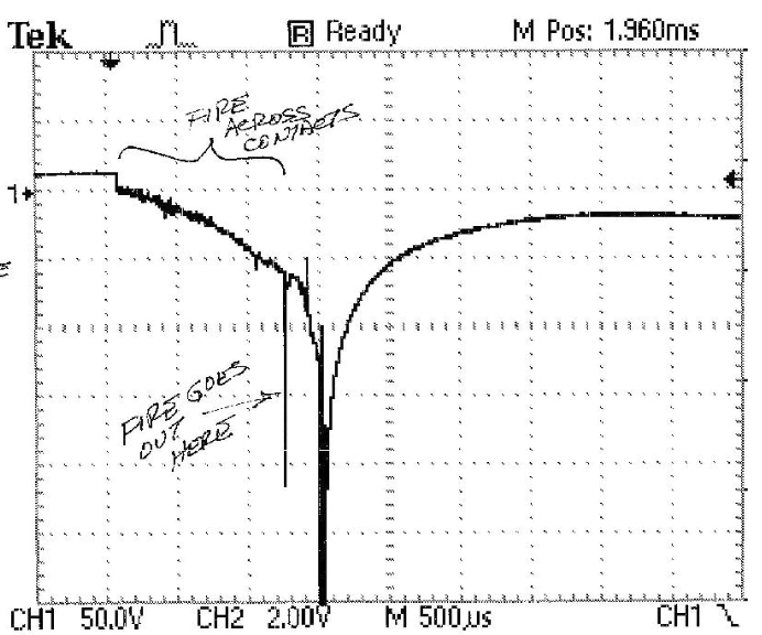

Another Symptom which might help the discussion.  The CB tripped ONLY at the moment of switching off the ALT.  It could be reset immediately after with no ill effects suggesting that it was something to do with the switching off itself that caused the CB to trip.
  Yup . . . that's how the transient event is
  created.
[img]cid:7.1.0.9.0.20180528140202.0205f138(at)aeroelectric.com.0[/img]
  When the controlling switch opens, the magnetic field
  in the relay collapse very rapidly (~3 milliSeconds
  in the plot above).

Bob:
With the screen shot of the O scope...
What signal did you use to trigger the scope (capture the screen shot)?
The 'M'...  Is that for Manual Mode?
Where do you have the leads attached?
Where are you measuring the ~3 ms from & to?
What is your definition of: "Fire across contacts" and Fire goes out here"?
Barry
