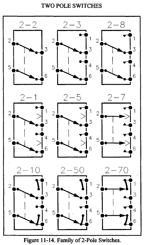

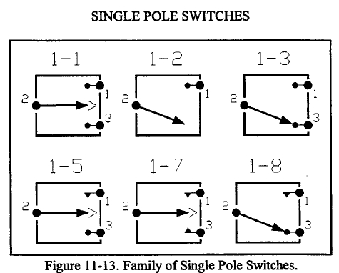

Hi Guys
I have a couple of (S700 series) toggle switches designated 1-10, from using my volt/ohm meter it appears to operate as a 2-10 - is this correct - in the AeroElectric Connection (my edition anyway) list of S700 toggle switches, it does not mention a 1-10 anywhere
Clarification welcome
John
PostPosted: Fri May 18, 2018 6:25 am    Post subject: 1-10 (2-10) toggle switch Reply with quote
At 07:58 AM 5/18/2018, you wrote:
--> AeroElectric-List message posted by: "JOHN TIPTON" <jmtipton(at)btopenworld.com>
Hi Guys
The "1" indicates a SINGLE pole switch
that will have only 3 terminals. "2" is
a DOUBLE pole device with 6 terminals.
[img]cid:7.1.0.9.0.20180518091920.0659d860(at)aeroelectric.com.0[/img]
[img]cid:7.1.0.9.0.20180518091920.0659d860(at)aeroelectric.com.1[/img]
The dash-10 functionality REQUIRES two
poles, hence there can be no such thing
as a 1-10 switch. I suspect that your
switch has been marked in error.
