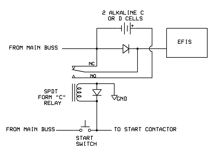

PostPosted: Wed May 16, 2018 7:54 am    Post subject: Re: Starting the Engine Reboots the EFIS Reply with quote
Below is an untried circuit for someone who likes to experiment. Instead of using a heavy lead acid battery, it uses two flashlight batteries in series. Depending on the load, and considering that the batteries will only be used for a few seconds at a time, size AA or C or D can be tried. The alkaline batteries will add 3 volts to the aircraft main battery voltage during engine cranking. The diode prevents the alkaline batteries from being shorted out. The diode also keeps the load energized for the few milliseconds while the relay contacts are in transition. The normally open relay contacts connect the alkaline batteries during engine start. After starting the engine, the normally closed relay contacts short out the diode during normal operation to give full voltage to the load. If the relay coil or N.C. contacts fail, the EFIS will still get power through the diode. Before I get flamed, I am not necessarily recommending this circuit, just offering it to experimenters.
 Filesize:  44 KB
 Viewed:  19108 Time(s)
Joe Gores

--> AeroElectric-List message posted by: "user9253" <fransew(at)gmail.com (fransew(at)gmail.com)>
Barry,
I used a program called Express.sch
It is free and can be downloaded here:
https://www.expresspcb.com
The program has two parts, the schematic part and the circuit board part.
Use teh schematic part: express.sch
After drawing your diagram, click FILE, EXPORT SCHEMATIC IMAGE.
The only choice for saving is as a BMP file.
Open the bmp file with "PAINT", a program that is built into all versions of Windows.
Crop the picture and then save as a JPG file.
Joe Gores
http://forums.matronics.com/ viewtopic.php?p=480173#480173

What would be wrong with throwing a big capacity directly across the power and ground as close to the EIS as you can?
That solution sounds reasonable in theory. The problem is that the starter motor would quickly drain the capacitor without a diode to block reverse current. Another problem is that one big capacitor rated at 15 volts or more would be impractically humongous. The solution is to use several capacitors, each rated at less voltage. Eric Jones & Eric Page have already done the engineering. Read this thread about the Deslumpifier:

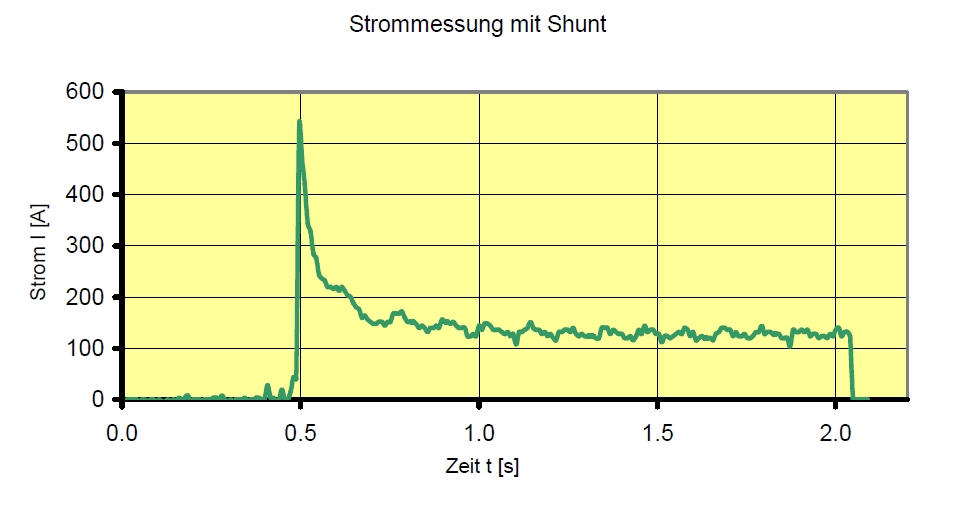

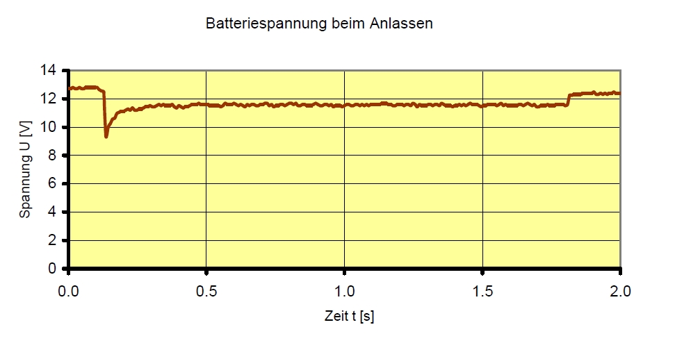

PostPosted: Thu May 17, 2018 12:00 am    Post subject: Starting the Engine Reboots the EFIS Reply with quote
The 2 attached (pilfered) figures aim to show when the EFIS reboot
occurs in the engine start sequence.
The deep voltage drawdown where the EFIS reboots is resolved as soon as
the starter motor picks up speed.
The "deslumping" only needs to hold up the voltage for a few hundred ms.
Jan de Jong
 Filesize:  79.57 KB
 Viewed:  19027 Time(s)
 Filesize:  85.1 KB

PostPosted: Thu May 17, 2018 1:11 am    Post subject: Starting the Engine Reboots the EFIS Reply with quote
It is a race with the relay and solenoid that enables the starter motor. A small relay will win I would think.
But I would prefer the "deslumpifier" of Eric Jones that Eric Page elaborated. No moving parts, no active electronics, no batteries.
Jan de Jong
