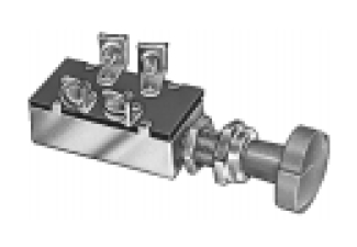

. . . . Not wanting to venture into the dark side of some of these "conversations", I just want to relay what I have personally viewed on this subject of old switches and WD40.....
Some legacy Cessna switches were simple pull-push, like a Master.
Geesh! That goes back aways. I think some of those
switches (automotive devices from the likes of
Cole-Hersee) were sill in production airframes
when I joined Cessna in '64. C-H still makes those
venerable devices.
[img]cid:.0[/img]
I have repaired 2 of them.  If one is (very) careful bending the retaining tabs the switch can be worked apart and resealed. What I found in both was severely hardened original lubricate. Hardened to the point that if a piece gets into the contacts, it can cause a faults.
Cleaning with the usual sprays and re-lubing with modern electrical grease has fixed both and they are still working today.... but, it was the old lube that caused random failure. These were master switches.
Yeah, fortunately the enclosure alloy would allow
opening and re-closing the tabs without fracture.
But I would have been hard pressed to 'sell off' the
procedure in a Service Parts Manual!

I illustrated is a Cole-Hersee 50047
which is probably available through a
Coll-Hersee dealer.
