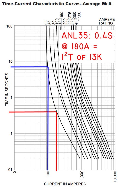

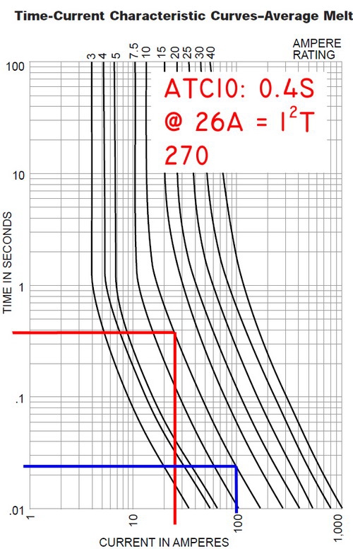

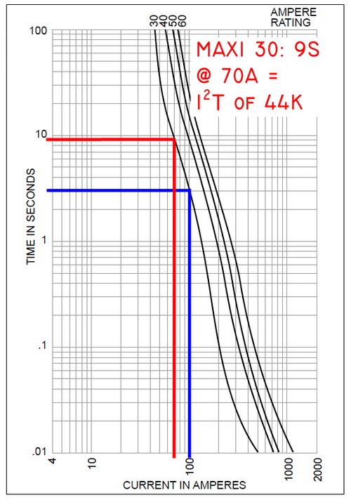

PostPosted: Tue Apr 17, 2018 2:22 pm    Post subject: z13 battery bus protection Reply with quote
At 09:55 AM 4/17/2018, you wrote:
--> AeroElectric-List message posted by: "mmcelrea" <mmcelrea(at)hotmail.com>
Will a maxifuse not blow as fast as a normal blade fuse? Is a slow blow blade fuse available?
No . . . and here's why . . .
Let's go to the engineering data for a sample of fuses
common to our designs. First the ATC10 plastic fuse
that fits the popular fuseholders . . . and probably
the largest fuse to be included on the battery bus
under consideration:
I have calculated a 'fusing constant' for this
fuse based on numbers taken from the ATC fuse
performance chart below. At approx 2x the 'carry
forever' current of the ATC10 fuse, it opens in
approx 0.4 seconds which produces an I(squared)T
value of 270. If we cause the fuse to carry twice
that value of 52A, we know that it will open in
approx ONE FOURTH that time or 0.1 seconds.
Double the current again to ~100A and we'll
anticipate fuse operation in ~0.05 seconds.
The chart below says it will be shorter still,
so perhaps my fusing constant number needs
trimming. Suffice it to say that the fusing
constant calculation carries an AMPS(SQUARED)
term in it suggesting that increasing current
shortens the operating time by 1/4th each doubling.
[img]cid:.0[/img] [img]cid:.1[/img]
Now let us look at the 30A MaxiFuse. Note that
it has a much larger fusing constant (again perhaps
needing a tweak) but consider the operating time
at 100A. From the chart we read something on
the order of 3 SECONDS.
Suppose a MAX30 were protecting the battery
bus with a ATC10 fuse in it and you fault
that fuse with a 100A load. The ATC10 will open
many times faster than the MAX30 thus the
integrity of the bus feed is not at risk.

Now, if we were protecting a SWITCHED bus in a TC
aircraft with similar distribution characteristics,
we might choose to use the ANL35 current limiter.
Note that its fusing constant is actually LESS
than the MAXI30. At 2x the ANL's carry forever
current, the fusing time is only 0.4 seconds. But
when loaded with our hypothetical fault of 100A
on an ATC10 fuse, the ANL35 is pretty close to
a never-operates condition.
[img]cid:.3[/img]

(2) The fusing constant is useful for making some
broad predictions about performance between
two styles of product. For example, in the
charts about we see that Kf of 13K for the
ANL (a mechanically robust fuse compared to
the MAXI) is about 20x faster at the 2x
overload point than the MAXI with a Kf of 44K.

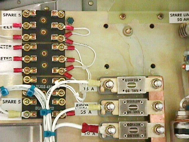

Having said that, I'd much rather the battery
bus was located near the battery.
The 30 Series aircraft at Beech have had fuses on the
firewall for decades
[img]cid:.4[/img]
Further, they were/are glass cartridge fuses (ugh!)
with threaded fasteners (fooey) . . . but I'm aware
of no problems with this design philosophy.
