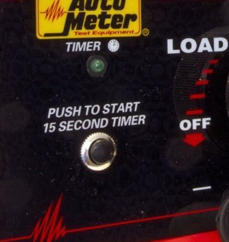

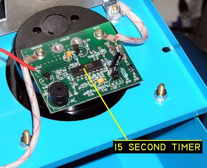

PostPosted: Wed Apr 11, 2018 11:47 am    Post subject: Please critique my electrical design Reply with quote
So....I'm betting that Mark meant he's measuring 10.6V *after* 15 seconds of cranking, but with no/minimal load on the battery. Now, go back to the Corvette/Chevette example. If you accelerate the Corvette for 15 seconds, it'll still have 400 HP, but you may only have 3 seconds of capacity (gas) left.Â
The legacy LOAD TEST is an artifact carried
over from the automotive world. Automotive
load testers have a built in 15 second timer
that drives a light or perhaps a beeper.
[img]cid:.0[/img]
[img]cid:.1[/img] [img]cid:.2[/img]
When testing a battery, one starts the timer and then
cranks up the load knob to depress and hold voltage
at 9.0 volts. At the end of 15 seconds, you get a light
or a beep whereupon you read the current being delivered.
This is a 'cranking amps' kind of current and a figure of
merit for battery's suitability for continued service.
Mark's test is even less valid if one has chosen a Lithium chemistry battery; their voltage has much less decline until it 'falls off the cliff' at full discharge.
Absolutely. The legacy lead-acid load test is
not applicable to lithium.
The real test is monitoring *how long* voltage remains above the voltage that indicates complete discharge (which is around 10.5 V), while the typical load from the plane's required (endurance bus) electronics is applied.
<27063fc.jpg>
<270642b.jpg> <270643b.jpg>
