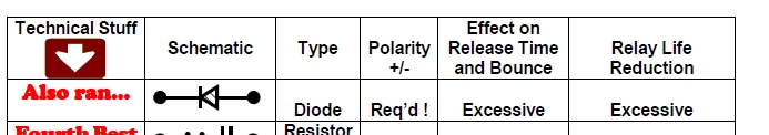

PostPosted: Thu Jan 18, 2018 2:01 pm    Post subject: diode on starter contactor Reply with quote
At 03:38 PM 1/18/2018, you wrote:
This subject has been discussed here for years.
My opinion and what I have suggested for years is that the current best practice is to use bidirectional zener diodes. Regular diodes are problematic. See attached.
[img]cid:7.1.0.9.0.20180118155821.0661d178(at)aeroelectric.com.0[/img]
Can you demonstrate this? "Excessive" is non-quantified.
Was my bench top study flawed in some way?
 Filesize:  59.17 KB
 Viewed:  18342 Time(s)
alec(at)alecmyers.com

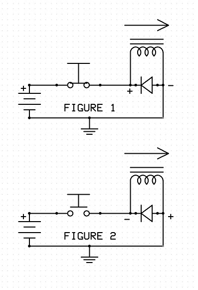

PostPosted: Thu Jan 18, 2018 4:50 pm    Post subject: Re: diode on starter contactor Reply with quote
A capacitor opposes any change in voltage.
An inductor (coil) opposes any change in current.
When the switch is closed (Figure 1), positive
current flows from left to right through the coil.
The diode does not conduct because positive
current can not flow against the arrow.
_
When the switch is opened (Figure 2), the
coil opposes any change and tries to
maintain the current. The coil is no longer a load.
The coil is now a source, like a battery.
Induced current still flows in the same direction
through the coil from left to right.
But the polarity has changed because
because the coil is now a source, not a load.
The diode now conducts because positive on
the right side flows with the arrow. Current
always tries to return to the source, the coil in
this case. It takes the path of least resistance,
which is through the diode, not across the open
switch contacts. The induced voltage is limited
to the forward voltage drop across the diode.
 Filesize:  68.61 KB
 Viewed:  18328 Time(s)

If your diode is installed backwards, it will conduct
HARD while the starter button is depressed. Plastic
diodes generally smoke for a few seconds and split,
some will literally explode. I've seen a few cases
where they simply fused short and tripped the starter
control circuit breaker.
If removing the diode cured your problem, then it
probably was 'backwards'. Do you have a breaker
or fuse on your starter control line? That shorted condition
should have opened the circuit protection.

For all intents and purposes the diode ONLY protects the switch that
controls the relay.
So it does improve system reliability.
Ken

I think y'all are a bit confused on what the diodes actually do. The diode across the relay coil is there to protect the controlling *switch's* low current contacts; not the relay contacts. Now, since TANSTAFL (there's no such thing as a free lunch), the  downside (of questionable significance) to the diode being in the circuit is that it *can* slow the collapse of the magnetic field in the relay, leading some to think (evidenced by the link to back-to-back zeners) that it puts the *relay* contacts at more risk.
Not to speak for Bob, but his latest post(s) address that  slowing of the magnetic field collapse (of questionable significance), and tell us that his testing has shown that with most relays, the contacts don't actually start to separate until after that slowed magnetic field decay isn't having any influence.
So....The bottom line is that the diode *is* needed to protect *switch* contacts, and its presence has *minimal to zero* real world impact on the *relay's* contacts. The takeaway is that you do need the diode, and nothing more elaborate than a standard diode is needed.
Those of us who made our living playing with these components have an easy time seeing what he's describing. It might serve you well to visit some appliance/electrical repair facility & talk them out of a couple of open frame relays so you can play with them & see what he's describing.

I am reluctant to get into another long discussion on the subject of
coil suppression but I encourage Googling the various extensive
resources on this subject.
Note that there are many techniques tuned to specific application on
this subject, but three things are true:
1) The use of a simple diode is contraindicated.
2) The use of a simple bidirectional zener is a good way to go.
3) MOVs are a good way to go, but they have a discrete lifetime...I was
never comfortable with that. MOVs are usually what fails in
surge-suppression computer multi-outlets.
One COULD use a zener and a regular diode in series, but a bidirectional
zener is polarity insensitive and stone simple.
Kilovac and Gigavac both use bidirectional zeners inside their
contactors for coil supression. What does these people know that you don't?

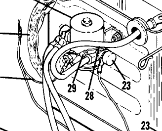

Spike suppression is (and always has been) indicated
for enhancing LIFE OF THE DEVICE THAT CONTROLS
the contactor. E.g. AD against key-switch. The
plain-vanilla diodes have been installed on TC aircraft
for decades. See item 29 in screenshot of 1969
C172 service manual. Couldn't put my hands on my
copy of the Beechjet manual . . . but the little
critters are sprinkled about that airplane as well.
[img]cid:.0[/img]
The diode has (1) no practical effect on service life
of contactor and (2) demonstrable benefit on service life
of the controlling switch . . .

Kilovac and Gigavac both use bidirectional zeners inside their contactors for coil supression. What does these people know that you don't?
Not a thing I can see . . . the bidirectional zener
performs as advertised. No reason to avoid it or to change
it out in favor of an alternative.
By the same token, there's no demonstrable benefit
for any extra effort to steer clear of
the lowly diode that has also performed as advertised
in literally billions of applications for a
very long time.
My complaint is with publications that make
sweeping assertions that are demonstrably
short on physical evidence or experimental
confirmation.

At 07:09 PM 1/18/2018, you wrote:
Last year I put a lighter AGM battery in my aircraft and moved it to the firewall along with the master contactor and made some new diodes for the contactors (one was broken). Saved about 4 pounds in wiring alone! Only problem afterwards was that if the battery was even slightly down sometimes the starter would turn a split second and then nothing. Repeated attempts usually ended up with the starter eventually running fine until the engine started. Putting a voltmeter on the starter confirmed that the problem was a lack of power to the starter, not the starter itself. I had a battery problem later on and replaced the battery, no change. Thinking I had messed up the starter contactor while tightening nuts on it I swapped it out, no change. At this point I started to suspect my diode so I disconnected it: Problem gone! I suspect I installed it backwards. Going to make the new one with clear shrinkwrap tubing so it can't happen again.
