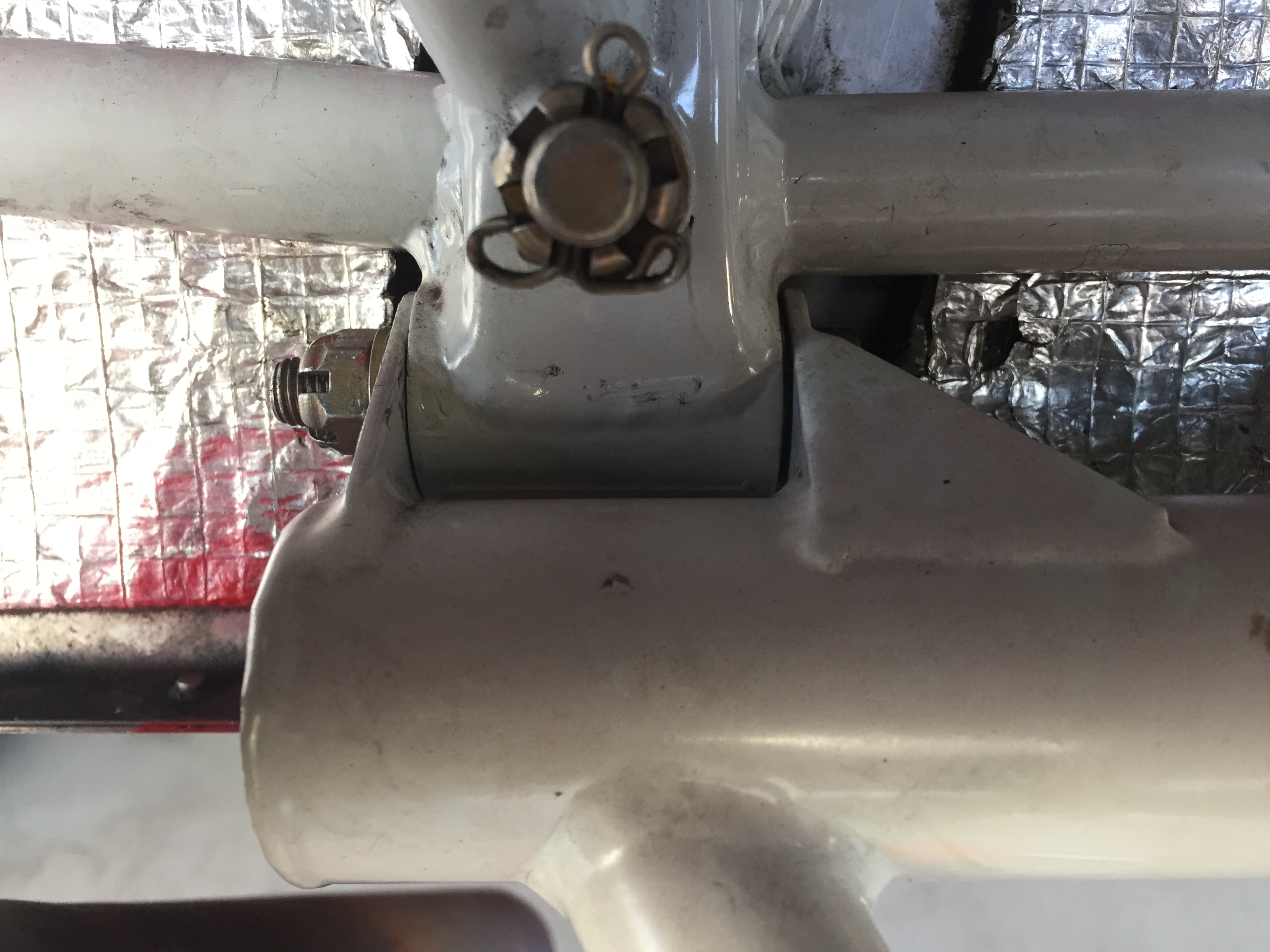

I just started getting some severe nose gear shimmy after 400 hours of flying. I figured it best to deconstruct my nose gear to bird-dog the problem from the ground up. I removed the wheel and raised the nose gear off of the ground using an eye bolt in the floor of my hanger. First off, I am getting a new front tire that I will balance before I install it.
But as I moved up the gear leg, I noticed that there is about 1/16" of play in my gear leg in the horizontal axis. This translates to 1/4"of play at the nose wheel.
There were quite a few posts about under sized bushings in the gear leg attach point a few years ago, but this is NOT the problem. My gear leg bushings are nice and tight to the ears of the gear leg. The problem is that the "ears" are too far from the "hole" on the engine mount. Could this be the problem that is causing my shimmy? Is there a remedy or should I just forget it, and why did this not cause a problem before. Has anyone else encountered this issue and how did you resolve it?
note space on right side of "ear"

PostPosted: Sat Sep 23, 2017 7:50 am    Post subject: Nose gear shimmy Reply with quote
Standby for other responses, but probably just need to tighten the nose strut by adding a shim to the elastomers. That's about the time when they start to compress.

Interesting. I'm getting ready to dig into mine a bit more because I suspect a similar issue. Going over a bump or lowering the nose to the runway usually results in a pretty good thump and my ears tell me there's some slack somewhere in the system that I need to find.
Regarding the ears, is it possible to ship the gap with washers so the ears fit tight?

Several things can cause the nose wheel shimmy. Usually the friction nut needs to be retightened to take up the slack in the belleville washers. It's tough to over tighten this nut.
The second is the axle assembly. If you are using the matco axle, confirm the the wheel is centered in the fork assembly. My original bushings were machines incorrectly and my wheel was not centered. If you are not using the matco axle, you need to order it.
Third, the tire provided with the kit is junk and should be replaced with quality tire such as a Goodyear flight custom or Michelin. My kit provided tire was way out of round.
The VA144 bushing that you are seeing play in should be installed in such a way that it protrudes from the edge of the gear leg assembly. When you tighten the nut you are tightening against the VA144 bushing. As I recall, washers can be used to take up any play as require. It's been a while, but I recall having to machine a new bushing to get rid of the slop in the gear leg. I'm not in front of the drawings at the moment, so excuse me for lack of assembly part numbers.

I agree with Bill, you need something like 20-25 lbs of breakout force on the nut and belleville washers. It states the correct number in the Vans' plans.
I also agree with Kelly, I haven't had any nose wheel shimmy with my IO-540. I'm thinking engine preference is not the issue.
You might stick a camera on your tie-down mounts and make sure its the nose and not the mains. If it is the nose it is either the belleville washers, the axle or the play in the bushings on the nose landing gear mount/engine mount. I had to make new bushings that had better tolerance than vans' bushings.

On the RV-14 (Same nose gear as the -10) I could swear that the original
plans
had it bumped up to 35lbs of breakout.  I just checked the plans now
though and they list 26lbs.  I would say stay on the high side of Sean's
numbers,
not the low.  By the time it gets down to 20 it's going to be pretty loose.
And, they wear in pretty quick, so after your first flight, check it before
50 hours, and then check it again at maybe 100.  After that it should be
more stable.

Soooooo, I am the original "poster" on this thread. Anyway, I installed (with Epoxy) an eye bolt in the rear concrete floor in my hanger. I raised the nose well off the floor. Then I completely disassembled my front gear and then put it back together. I bought an all new front tire (a Condor tire by Michelin) that my local FBO balanced for me. I did not know that Condor is Michelin's sub brand - might even be the same thing. Made in Thailand by Michelin.
It is important to align the little yellow dot with the valve stem to facilitate the balancing. It was a fun but time consuming project. I also did the installation of the AD/SB plate that I had not done (Vans S/B 14-08-29). The big shimmy is gone, but I did have a little bit at about 20-30mph on a rough runway today.
But as the shimmy is gone at high speeds, I consider the issue resolved. My vote is that if you have not had shimmy and it develops, consider a new tire and GET IT BALANCED CAREFULLY!
