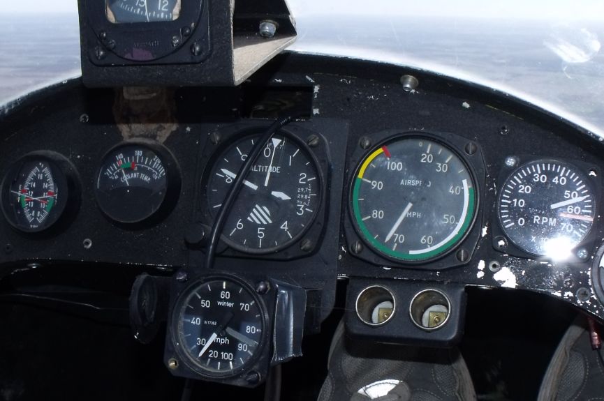

You left out reducing drag. Same result as increasing thrust. One very good way to do that is to seal the rudder end of the boom tube. See the attached photo. The Winter ASI just below the altimeter is connect to a tube measuring airflow coming back up the boom tube. At 72 mph indicated the wind flowing back up the boom is moving at 25 mph. That's a fair amount of drag to delete.

My first guess as to the cause is that there is a low pressure being "felt" at the front of the boom tube. This can be caused by a couple of things. The airflow swirling around the pilot and fuel tanks coiuld cause an area of low pressure behind the pilot, and the front of the boom tube could be near this low pressure area. Also, remember that the propeller creates low pressure in front of itself, and high pressure behind itself. The front of the boom tube is near this low pressure as well.
I really doubt that there is a higher than normal pressure at the back of the tube that is "blowing" air forward, because there is nothing back there to cause that high pressure. It seems likely to me that there is "suction" at the forward end of the tube "pulling" air forward.
Very interested to hear what the difference is before/after you plug the tube.

 You left
amount of drag to delete.  Rick

The difference is you don't have a boatload of freezing air blowing on your right side in the winter.
