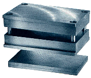

I'm not so sure that nitriding will eliminate...or even help the Corvair
crank breaking problem...
I'm not an expert on nitriding, but I've been around it a little in my
time... I used to machine plastic ejection molds and tooling dies... There
are what's called "ejector pins" that the tops of mold and dies slide up and
down on to make the 2 halves meet properly...
If you can imagine a 4 legged table sitting on it's top with the 4 legs in
the air, then cut a piece of plywood with 4 holes in it to fit over the legs
and slide up and down, this is what it's equivalent to... The legs would be
the ejector pins. (I've attached a picture of a MUD Die) We used to have
these pins nitrided all the time... Nitriding, at least what the nitriders
told me, is that it doesn't make the part more resistant to breakage, but it
makes it tougher from a wear perspective... I know on molds and dies, the
top half sliding up and down through every cycle on the ejector pins, they
would wear, then the 2 halves wouldn't match up right...they'd mis-match...
We'd nitride these pins to make their outer surface harder to resist
wear...they'd still break as easily as they were before nitriding, if side
load was applied, their outter surface just didn't wear as fast... You can
hit a nitrided part with a file and the file will just bounce off it...but
keep on filing, and in a few thousandths, you'll be through the nitriding
and the steel will be soft as ever... SO,
from my limited experience and knowledge of nitriding, if I was having a
crankshaft that was wearing out quickly on the bearing journals, nitriding
seems like a good cure..but to use as a cure for breakage from side load, it
just doesn't make sense to me... In my thinking, you'd need a flange and a
thrust bearing to handle side loads... Anyone out there care to elaborate
more on nitriding??
Maybe I'm way off base here... Don't know... I will say that at this time I
plan on using a WW Corvair conversion in my XL when the time comes... Good
lord, I'm just working on the wings right now!
Just my .02 worth...
Randy
XL Wings - Plans Only
http://www.n344rb.com

naumuk(at)alltel.net Guest
Posted: Sat Jul 08, 2006 5:01 am Post subject: Corvair cranks |
Randy-
You're describing the guide bars, not the ejectors. They depend on
bushings for alignment and to cut down on wear.
You are right about the ejector pins and slides, though. TiN is used to
fill the surface imperfections of a part after grinding to cut down on
friction, thus surface wear. That's the concept behind a TiN drill bit. They
last longer not because they're tougher, but slipperier.
I have absolutely no idea how this applies to the Corvair cranks- you
just asked about TiN.
Bill
