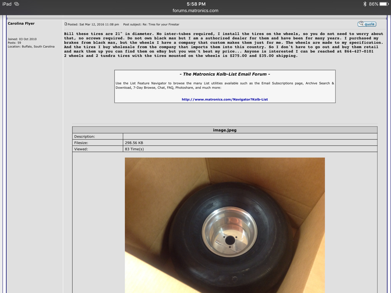

Here is a screen shot of what I posted

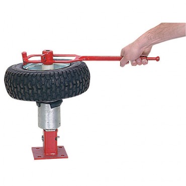

Bill, I use a cheap harbor freight device for putting the tires on, cost $49.95 I think.
Rick, The only tires that I sell are these that I have pictures of and they fit on a 8 inch rims

  Flyer" <joe.a.lawson(at)gmail.com (joe.a.lawson(at)gmail.com)>
 the
