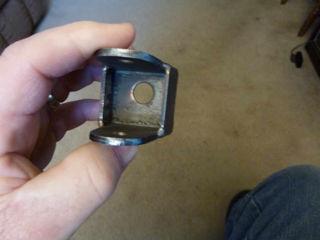

That seems like a lot of work compared to the 20 seconds it takes to reset an adjustable trim tab.
For a more permanent adjustment on an airplane where the wings have a different angle of attack, Kolb makes and sells an offset U-joint bracket. I don't know what they charge for them, but I have one I don't need. Be glad to sell it for the cost of shipping. It is for a MKIII/FSII, don't know if it will fit the Xtra. PM me.
