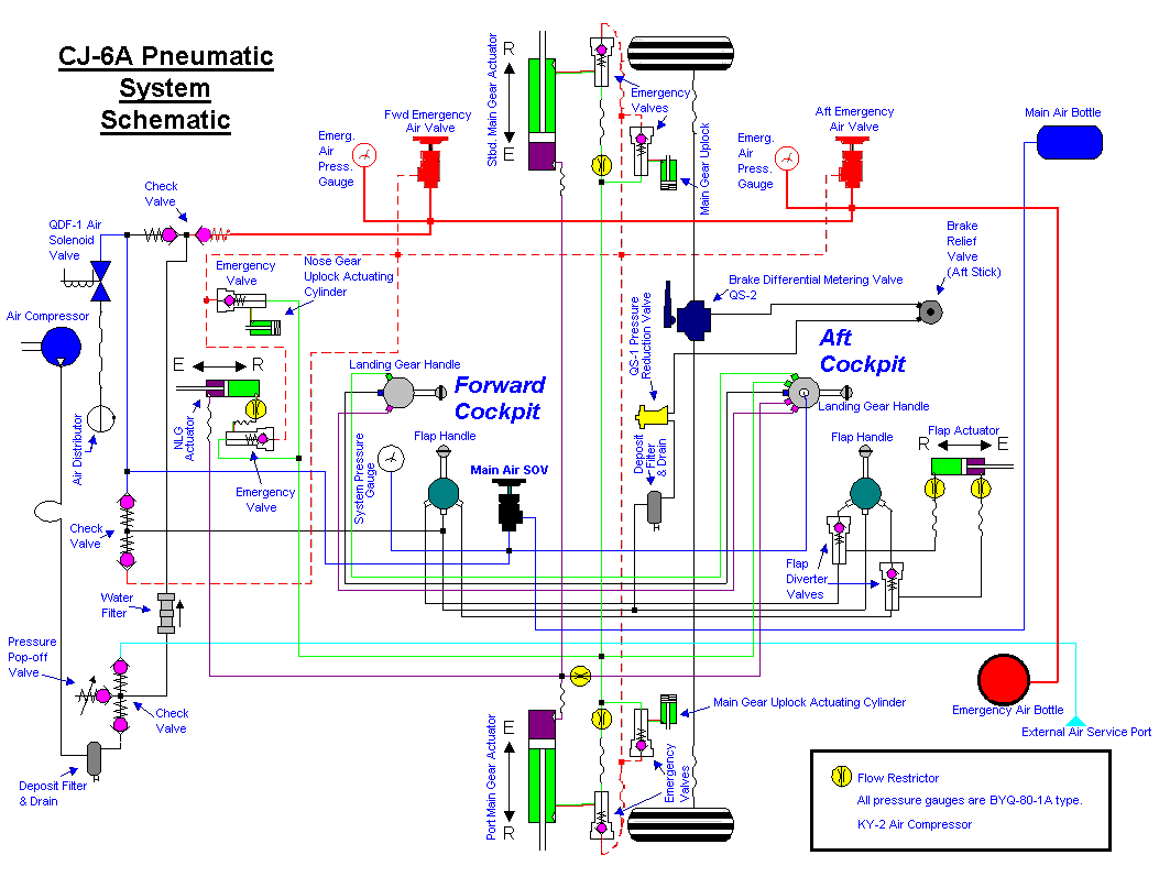

possibly consider the restrictor plate on the retract side. It be should located in the rear cockpit, left side of the plane not too far from the gear handle on a blue white blue line at a 4 way connector. A popular schematic (attached) shows this restrictor in a position to affect all 3 gear. My interpretation of the Chinese schematic (also attached) shows it on the nose gear side only. Don't know which is correct or where yours is.

For what it's worth. These restrictor plates are about the size and shape as a contact lens and have a very small hole in the center. It is real easy to undo a gear line and have it fall out and never notice it. Many times they stay tucked inside the b-nut so you have to tap it to get it loose or take a look in to see if it's there (and maybe gunked up.)
I know the parts book references it a shock absorber or something similar , but I don't believe there is a picture. Doug sells blank plates and will provide you with a nominal hole size to drill. The hole size can be changed to increase or decrease speed of retraction/extention
