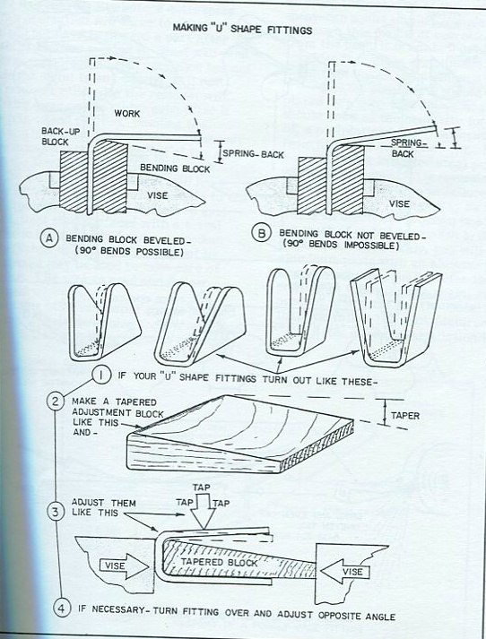

Richard Pike
Posts: 1671
PostPosted: Sat Jan 17, 2015 4:35 pm    Post subject: Re: Form blocks Reply with quote
From Tony Bingelis' book "Sportplane Construction Techniques."
 Filesize:  158.58 KB
 Viewed:  7645 Time(s)
Richard Pike
Kolb MKIII N420P (420ldPoops)
Kingsport, TN 3TN0
frank goodnight
Joined: 27 Dec 2011
Posts: 126
PostPosted: Wed Jan 21, 2015 8:25 am    Post subject: Form blocks Reply with quote
Thanks Richard,
I seem to remember seething about
7degrees.gues I will know soon as I cut one.
Frank
