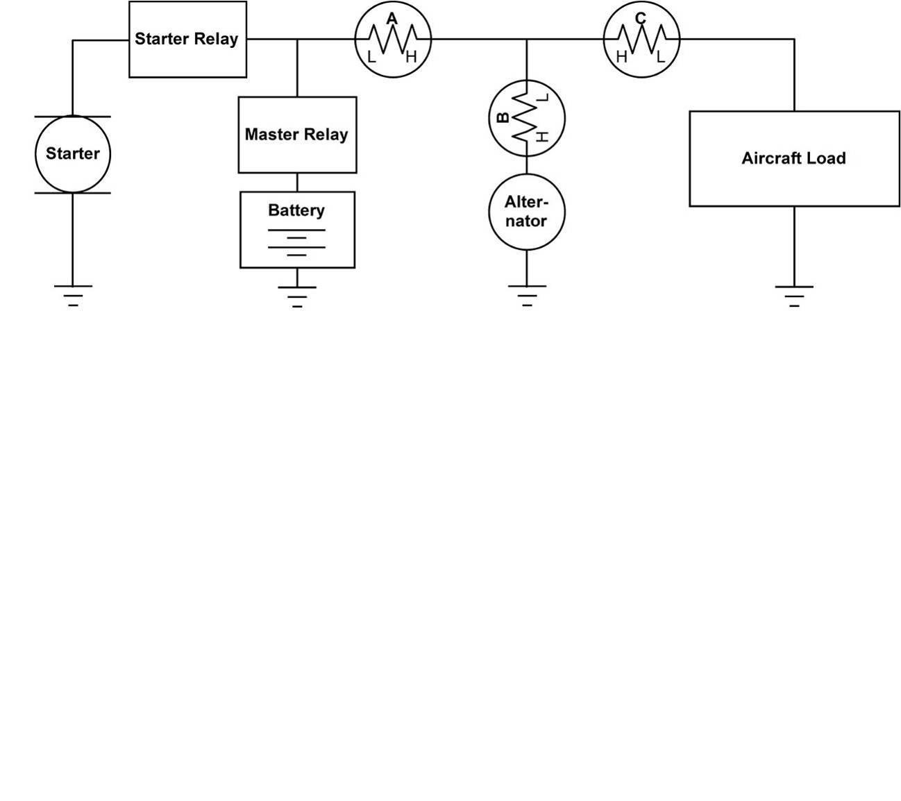

See the attached picture from Dynon's installaiton manual. Is the shunt
located in position A or B or C? When the shunt is located in position "A",
which measures current into or out of the battery, as you know, very little
current flows through the shunt when the battery is fully charged.
The following pertains to a shunt in position "A". The engine needs to be
off while troubleshooting. If the electrical system operates normally, the
shunt must be good. If the shunt has a higher than normal resistance,
then there would be a larger voltage drop across the shunt. This would
show up as lower system voltage and a higher ammeter reading.
Since the electrical system operates normally, I suspect a bad connection
between the shunt and EFIS, or a problem within the EFIS.
Even though the EFIS displays amps, it actually measures millivolts.
I would test the EFIS by applying a millivolt signal to the ammeter input.
This millivolt signal could be provided by a resistor network or by an almost
dead flashlight battery.

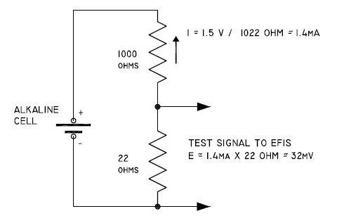

PostPosted: Sun Aug 10, 2014 9:56 am    Post subject: Shunt Questions Reply with quote
Even an 'almost dead' battery is probably too much . . .
Suggest you craft a millivolt test source from a couple of resistors and a good flashlight cell. Any other combination of resistors can be used as long as you hit the 'output target' in the upper half of a 50mV full scale input to the EFIS.
[img]cid:.0[/img] This is not an 'accurate' source, only a practical source for carrying out a divide-and-conquer experiment to isolate your fault.
