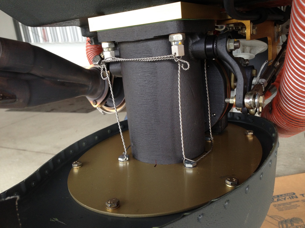

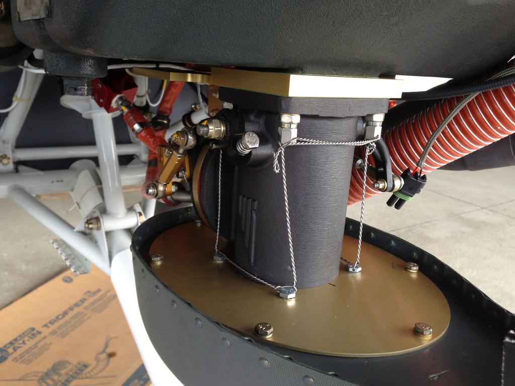

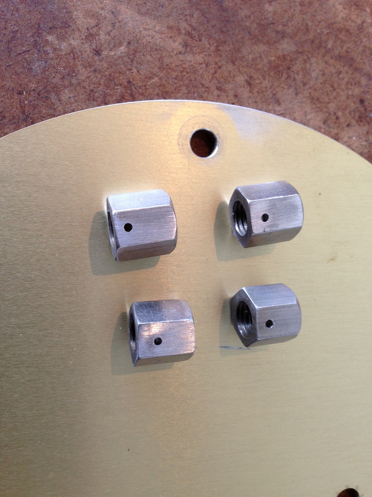

Now for the fix: The filtered airbox bolts are located right underneath the
mounting studs for the throttle body assembly. I simply replaced these bolts
with drilled head bolts and made some drilled coupling nuts to put on the
throttle body studs, there was plenty of extra threads exposed on these
studs so I didn't have to make any changes to the studs or the nuts that
hold the throttle body in place. Then just safety wire the whole thing
together. I used 0.040 wire to tie each filtered airbox bolt up to the
mounting studs. Below are pictures of the drilled nuts and the final
installation.

Pictures attached are of the drilled retention nuts and the updated
installation.
installation.
Obviously I would highly recommend that if you have an Airflow Performance
fuel injection system with a vertically mounted fuel servo you take a look
at your installation and consider adding some securing means to ensure this
thing can't come apart on your airplane. They key issue is that disrupting
the airflow inside the fuel servo can make the engine STOP RUNNING!
installation.

PostPosted: Sun Apr 06, 2014 10:23 am    Post subject: Engine out over KOCF Reply with quote
Bob,
An involuntary glider ride is no fun -- I'm glad you were able to land safely.  Thanks for sharing your experience (and the cause) with the group.
I'm confused by the safety wire shown in your photos (particularly the vertical runs of safety wire up to the coupling nuts).  Is your primary intent to safety the 4 drilled-head AN-3 bolts that penetrate down through the FAB aluminum cover?  If so, normal practice as I understand it would be to just safety wire those AN-3 bolts to each other in pairs (as shown in AC 43.13-1B, page 7-20, Figure 7-3, for example).
[img]cid:part1.00050504.09070001(at)comcast.net[/img]

PostPosted: Sun Apr 06, 2014 11:15 am    Post subject: Engine out over KOCF Reply with quote
I second that, the vertical safeties are not needed and the wraps are not tight near the bolt heads. Refer to the drawings

PostPosted: Sun Apr 06, 2014 12:09 pm    Post subject: Engine out over KOCF Reply with quote
I've got no experience with that system, but I read the original post as
saying that the stock setup only uses a clamp around the inlet neck of
the throttle body to hold the airbox on the throttle body. I thought
that he was using the vertical runs of safety wire as a safety to keep
the airbox up if the clamp releases its grip (again).

PostPosted: Sun Apr 06, 2014 12:52 pm    Post subject: Engine out over KOCF Reply with quote
Charlie has it right. The whole point is to provide a safety means in the vertical direction. The clamping doughnut is below the filtered airbox plate and not visible in the picture. The four bolts that I safety wired to thread into the doughnut. I safety wired between the bolts to provide additional protection against them backing out. However, those four bolts could be removed and as long as the clamping doughnut remained tight the box can't come off. Lastly the vertical safety wire doesn't exactly need to be crazy tight as it would require about 3/4" of travel before the doughnut comes disengaged from the fuel servo.

>>> Now for the fix: The filtered airbox bolts are located right underneath the mounting studs for the throttle body assembly. I simply replaced these bolts with drilled head bolts and made some drilled coupling nuts to put on the throttle body studs, there was plenty of extra threads exposed on these studs so I didn't have to make any changes to the studs or the nuts that hold the throttle body in place. Then just safety wire the whole thing together. I used 0.040 wire to tie each filtered airbox bolt up to the mounting studs. Below are pictures of the drilled nuts and the final installation.
>>> Obviously I would highly recommend that if you have an Airflow Performance fuel injection system with a vertically mounted fuel servo you take a look at your installation and consider adding some securing means to ensure this thing can't come apart on your airplane. They key issue is that disrupting the airflow inside the fuel servo can make the engine STOP RUNNING!
>>> Lastly, I've collected the flight data out of my AFS EFIS system which I just happened to have running at 2 second intervals. Its been very instructive to see exactly how the whole event played out. I could see my various attempts to get the engine to run properly by changing throttle positions and the hopeless lack of actual power. You could see the excess fuel just crater the EGTs, and now in hind sight I may have been able to get some power back if I had the insight to try and close the mixture radically. However, I can say with confidence my total focus after about 1 or so minutes of trying to get power was on flying the plane to a safe landing.... mission accomplished.
>>> Pictures attached are of the drilled retention nuts and the updated installation.
