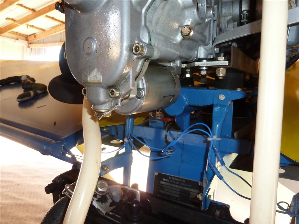

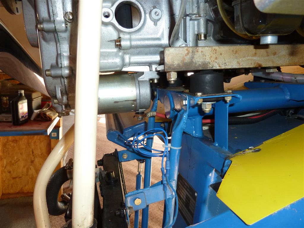

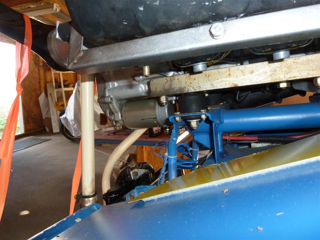

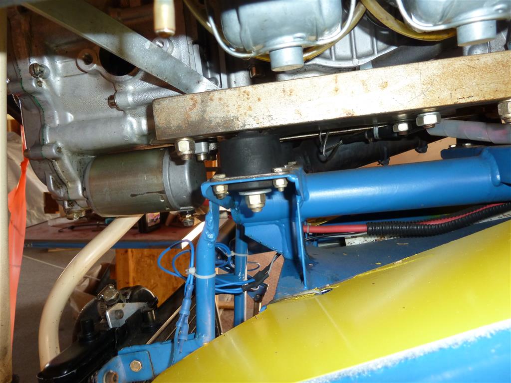

Here is how it fits on the FSII, don't know if it is the same, but this may help. You can at least see the relationship between all the usual Kolb parts and the starter.

Don't know about the slingshot. On the Mark 3 you have to raise the motor or move it back. The starter hit the rear mount
