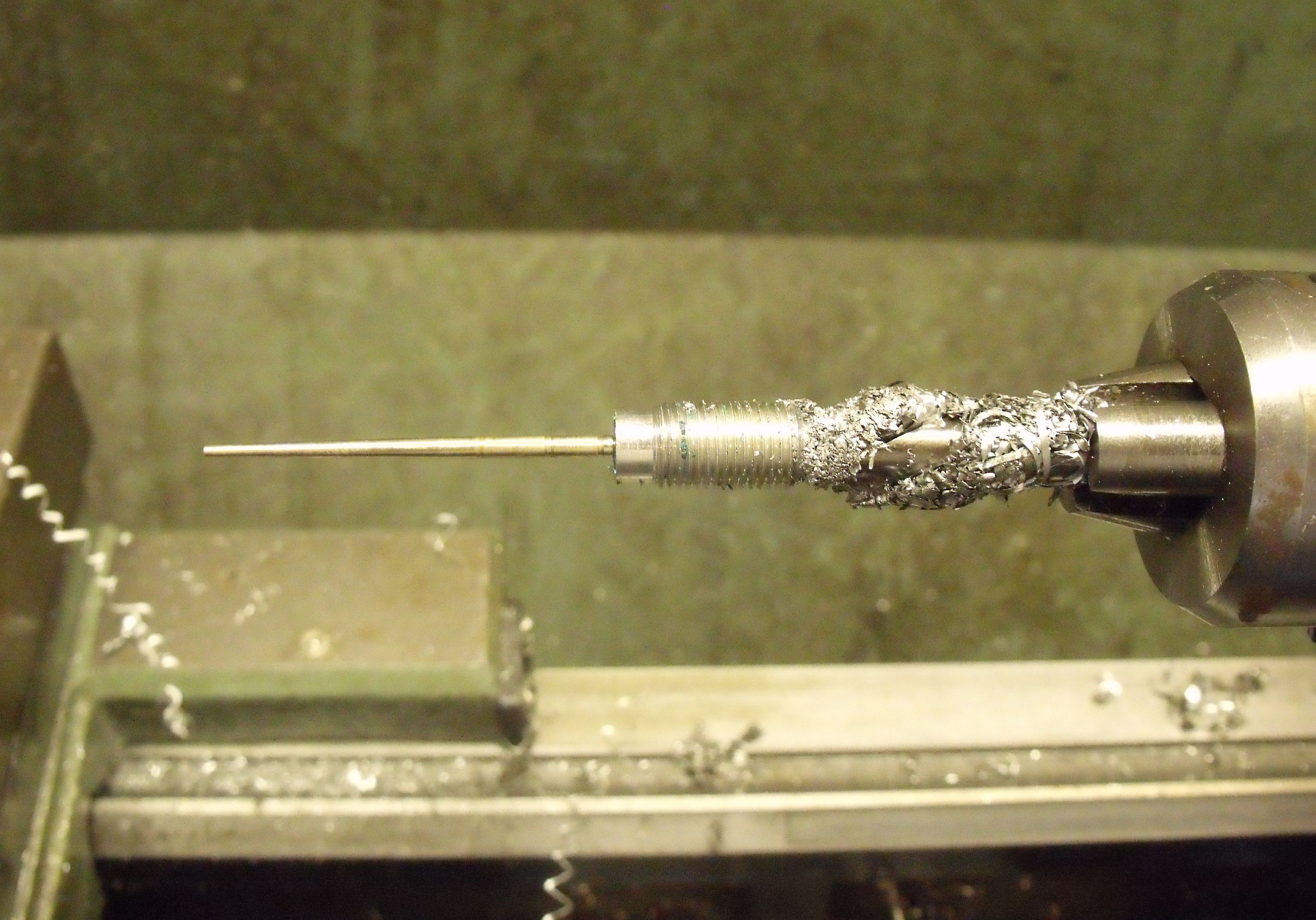

Let's face it, there are ham handed people in this world who should not be allowed near fine machinery. The fellow who logged that he "cleaned" the carbs on the 912 belonging to my customer is one. He put the fixation screw holding the jet needle in so tight that the screw driver slot just stripped off its ears when I tried to get it out. Soaked it with PB Blaster for 36 hours and no luck. Chucked the piston in my lathe, touched the top of the screw with a center drill and chucked up a left handed drill bit. Took longer to set up than it did for the drill to pull the screw out. As you can see by the picture the needle is quite literally jammed into the bottom of the screw. The carb piston, thankfully, is completely pristeen.  Did I mention that I love left handed drill bits?

It wasn't the mechanics fault. These fixation screws have Loctite on them from Bing and they can strip out if not heated. Once in a while I find one I can remove without over torquing it, but most times I heat them with a heat gun or small butane torch. Once heated they come right out.
