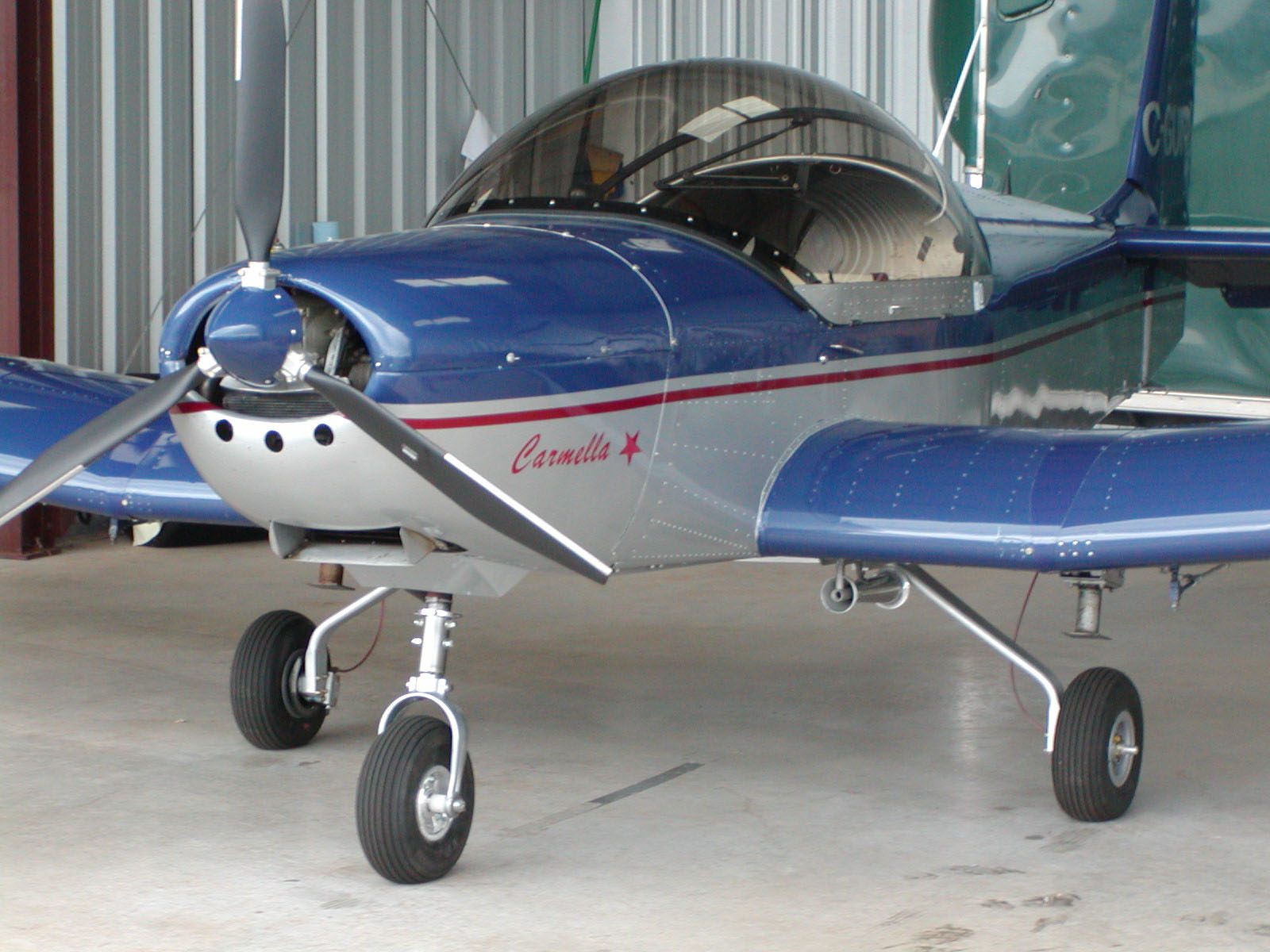

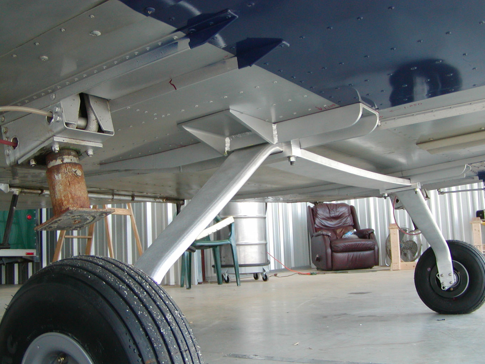

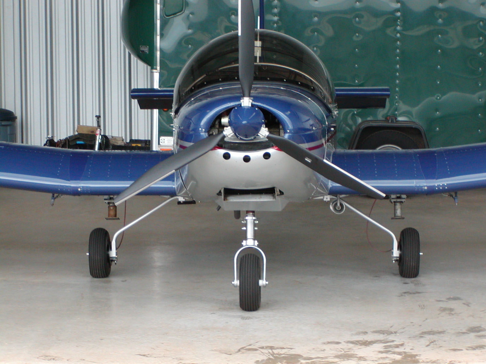

The pictures attached give an idea of what was done in this case.
Though I don't believe the spring gear has any advantage
due to its weight and light attachment if you repeat XL structure. You
damage the spring gear and you destroy the fuselage
and all.

I was asking about Larry's plane specifically. From what I see in his photos
he has the spring gear but still has the stubs of the factory gear
protruding from the bottom of the wings.
-- Craig
larry(at)macsmachine.com
PostPosted: Mon Jun 12, 2006 9:42 am    Post subject: CH601HD/HDS Main Gear Reply with quote
Craig,
I think in considering the weight that was added, the builder may have
had second thoughts about
what he'd done. The old gear looked like it had been there for a long
time without paint.
I'd have replaced the old gear struts or blasted and painted them again.
Larry Mc
