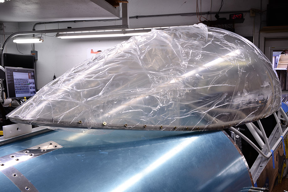

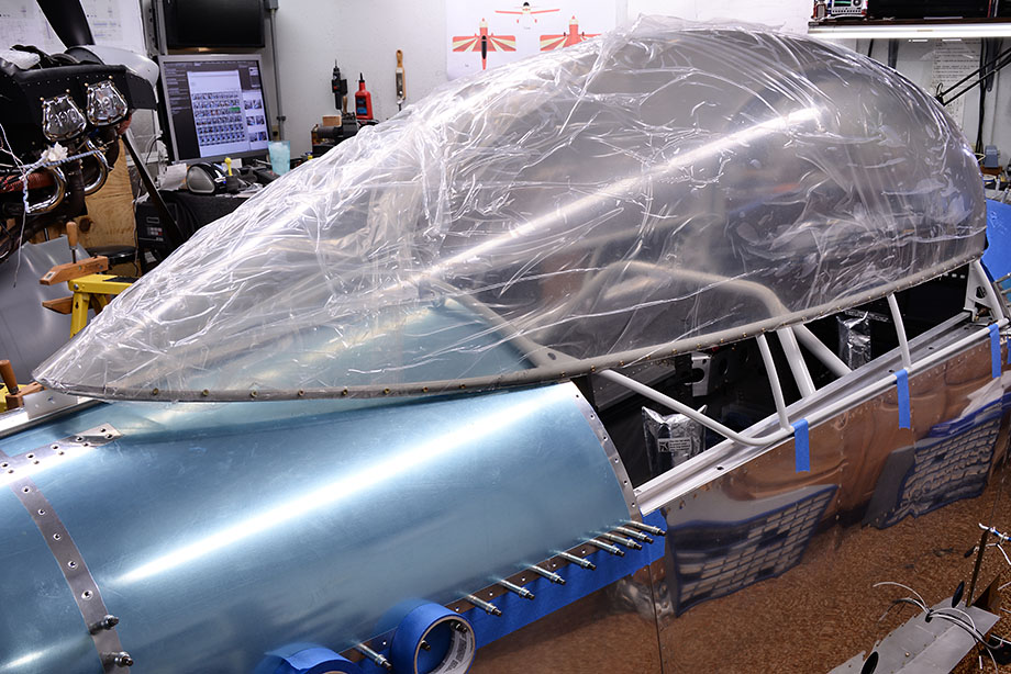

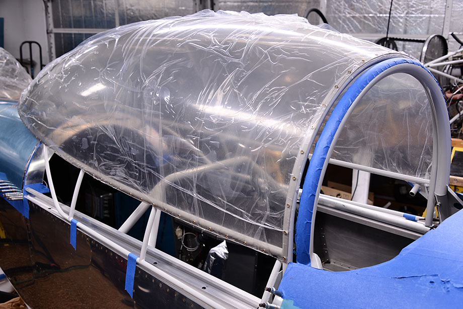

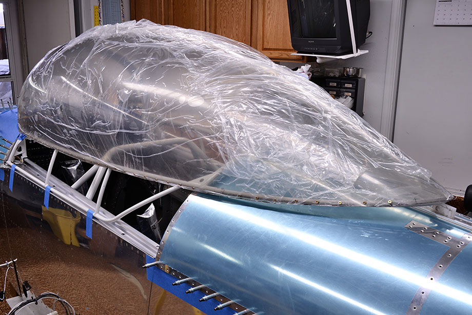

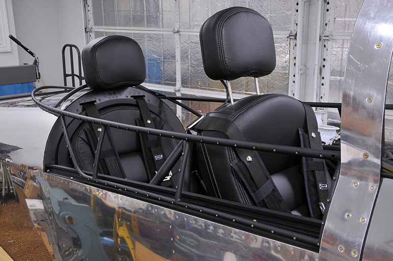

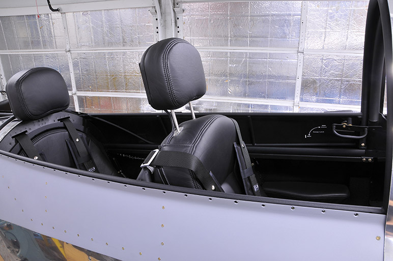

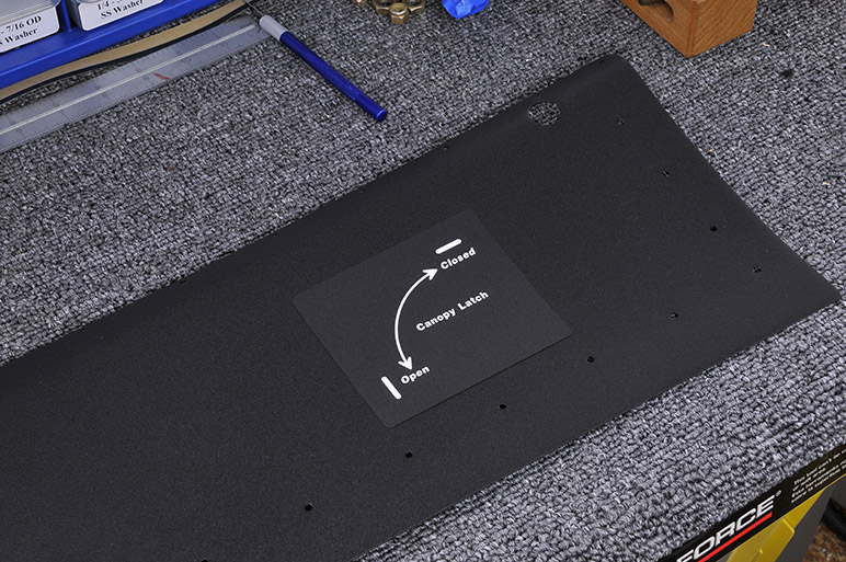

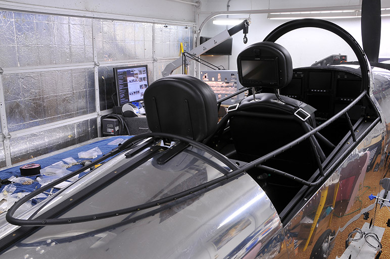

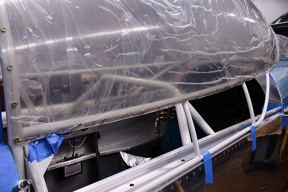

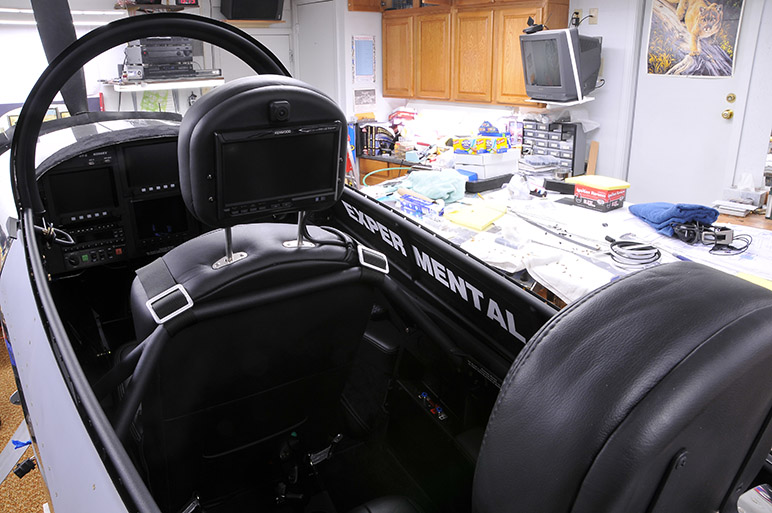

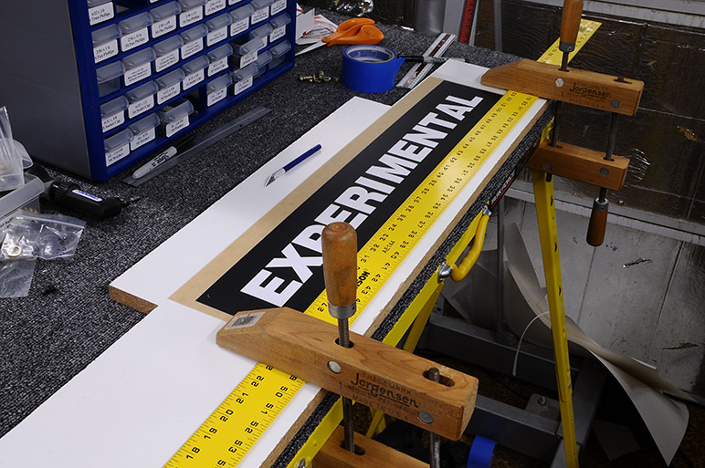

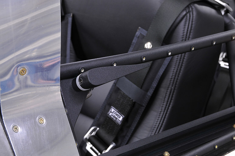

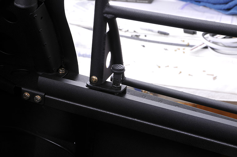

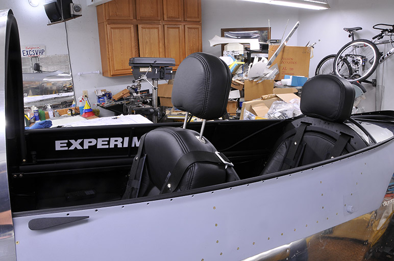

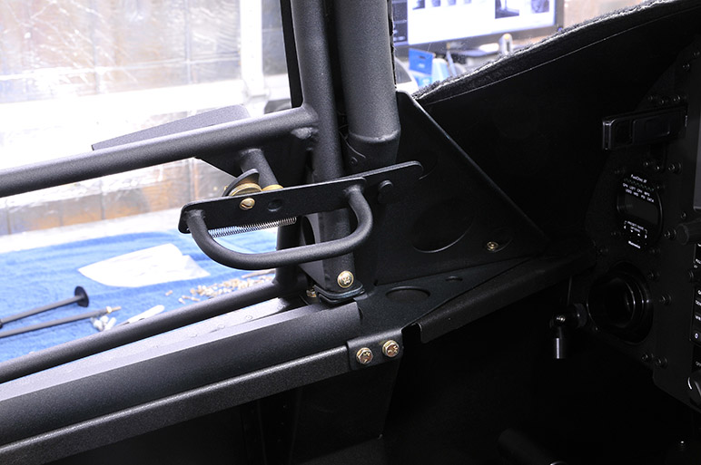

Yahoo! I'm elated to report that the Canopy 2.0 on Ruby 2.0 came out nearly perfect! I'm happy to report that the #6 tapping and screws works GREAT! Van's should recommend this as the standard installation. The best part is that you can "retap" the holes slightly to make sure that the flush-head of the screw perfectly aligns with the varying contours of the Plexiglass as you work around from the front to the back. Amazing! The screws seem to have plenty of bite into the steel frame and considering you don't want to ever over tighten them anyway for fear of cracking the Plexiglass, there shouldn't be any problem with the threads holding up. Attached are a few pictures.

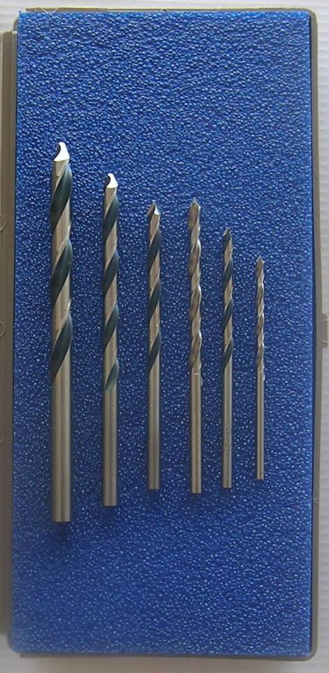

I used special pointed tipped plexiglass drill bits from Avery Tools. Didn't see that mentioned. I suppose you could grind the ends of conventional drill bits to a sharp point.

Yes, I did in fact use these very drill bits from Avery to enlarge the holes in the Plexiglass from #40 up to 3/16" for the #6 screw. They work great! Also, I strongly recommend putting a piece of wood behind the Plexiglass with a ClecoClamp before drilling. Didn't have a single problem with any of the holes; and I've got a couple that are a little close to the edge. By the way, the 3/16" hole for a #6 may seem like a lot, but the swimming room greatly reduces the stress on the Plexiglass by any given screw. Consider also that most all of the screw holes are sandwiched between the tube and the fiberglass skirt, so all you really need is the clamping action (and just a little shear action).

2010.01.19_-_RV-8_-_Canopy_Frame_Side_Panel_Labeling_&_Installation_Complete_(10).jpg
 Filesize:  131.54 KB
 Viewed:  13329 Time(s)
2010.01.19_-_RV-8_-_Canopy_Frame_Side_Panel_Labeling_&_Installation_Complete_(11).jpg
 Filesize:  140.23 KB
2010.01.19_-_RV-8_-_Canopy_Frame_Side_Panel_Labeling_&_Installation_Complete_(13).jpg
 Filesize:  106.8 KB
