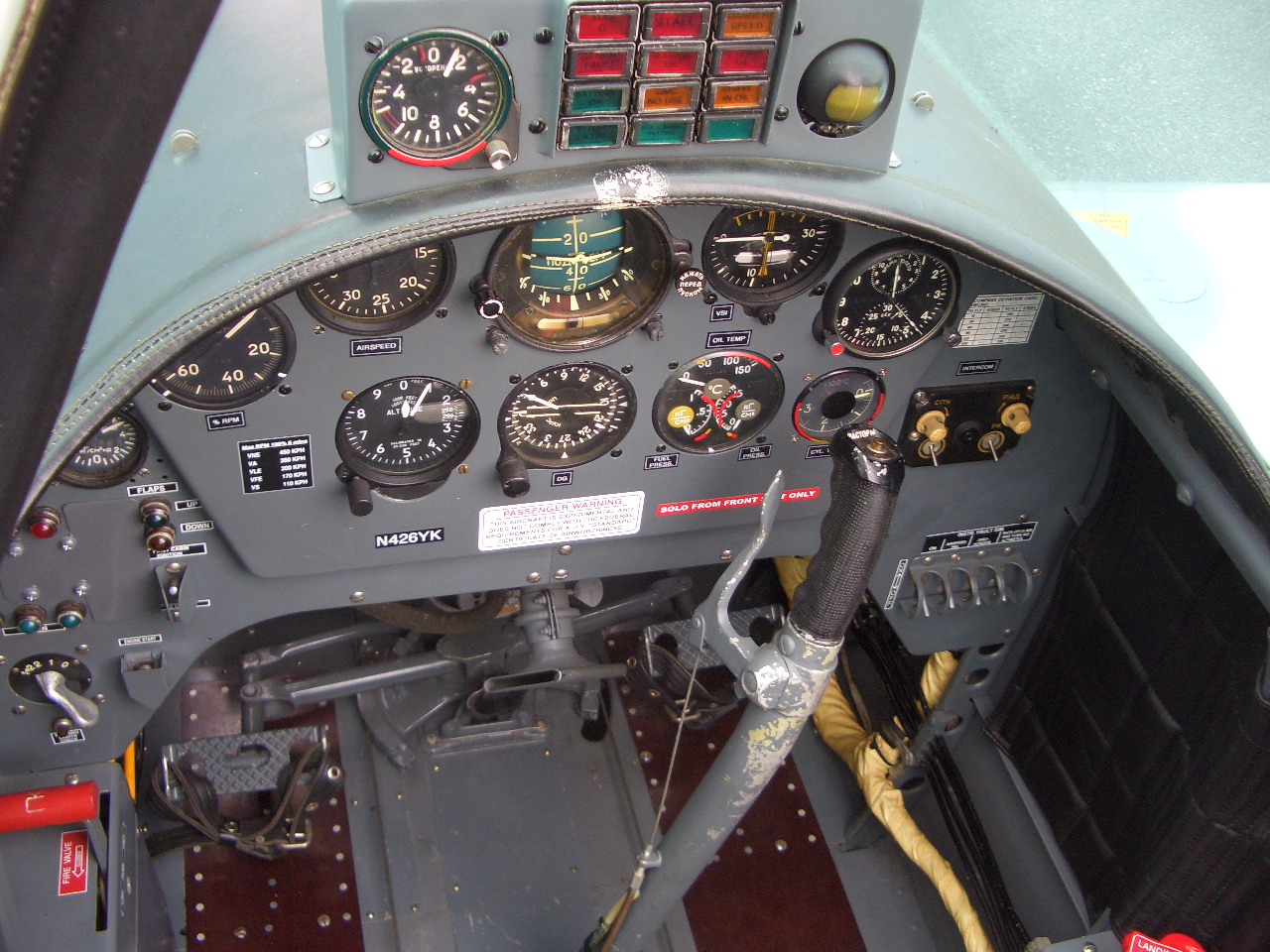

Fabricate a bypass (there are 3 sets of "in's and out's. ie: 6 fittings
on the rear selector) and eliminate it completely from the system. It
is totally unnecessary and only another point of failure due to lack of
use as many people have found out. Photo attached is of a Yak 52
without a rear gear selector.
Dennis

I have done several hundred hours of instructing in the 52....checkouts, acro training, and spin training. I am unwilling to work in a rear cockpit in which the rear gear selector has been blocked off in neutral, removed or otherwise emasculated.
My choice, of course. But the airplane was designed to be fully flyable by an IP in the rear seat...and that's the way I like it to be. YMMV
Roger Baker
