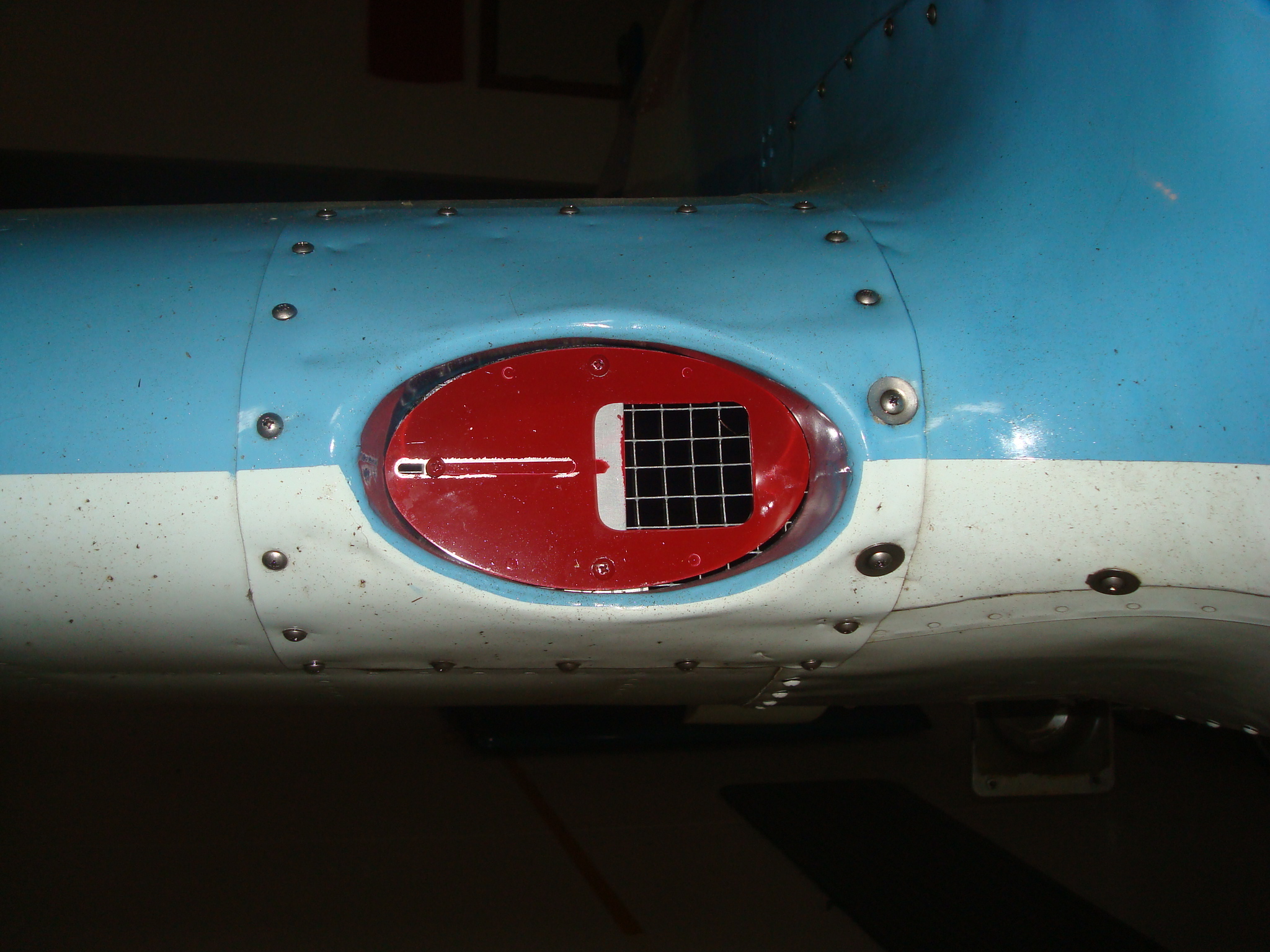

Doug Sapp makes a very nice kit for the oil cooler inlet duct. It includes a screen to keep debris out of the duct year round, and a removable, adjustable restricter plate for the winter. A photo is attached. It does a good job of keeping the oil temperature where it should be,

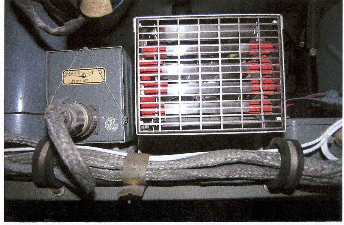

I'll turn the hangar heat on a few hours before the pre-flight, and have no problem starting or getting the oil circulating. For the pilot, get a CWU-64/P winter nomex flight suit. These show up as surplus on occasion. I am still running the original generator, so with excess available electrical power, there is a 24 volt quartz heater under the rear panel for the passenger. With a bright sun shining in through the plexiglass canopy, this combination has been comfortable down to 10 DegF.

Robert,I have a few of the CJ winterization kits in inventory, fits into the wing oil cooler duct also comes with a FOD screen to prevent trash from being placed into your duct while at a airshow. I built this screen after finding a paper coke cup and a burger wrapper in my oil cooler duct during preflight just before leaving a air show. These will not fit the Yak 52.

Please tell us more about the 24 volt quartz heater. Brand, where you got it, that sort of thing. Photo(s) would be great. It's not that cold up here in Vancouver but the damp really gets to a person.

Check out S24-3500 or S24-4500 at this link. http://www.sportsimportsltd.com/us-made-polymer-composite-12-24-36-or-48-volt-quartz-heater.html
Photo shows the heater mounted on the cross member behind the front seat. Switch is in the right front console and wired to the battery buss. Amp meter will definitely let you know when the heater is on.

The 3500 model draws 35 amps and the 4500 model draws 45 amps. Yikes. You need to run #8 GA wire at a minimum (http://www.windsun.com/Hardware/Wire_Table.htm) in the 24 VDC system. Also, the heater draw along with the avionics draw will nearly exceed the capacity of the generator. Most US alternators put in these planes are rated at 50 Amps.
A better choice is battery powered heated clothing. No need for wiring or a cigarette lighter to plug them in.
