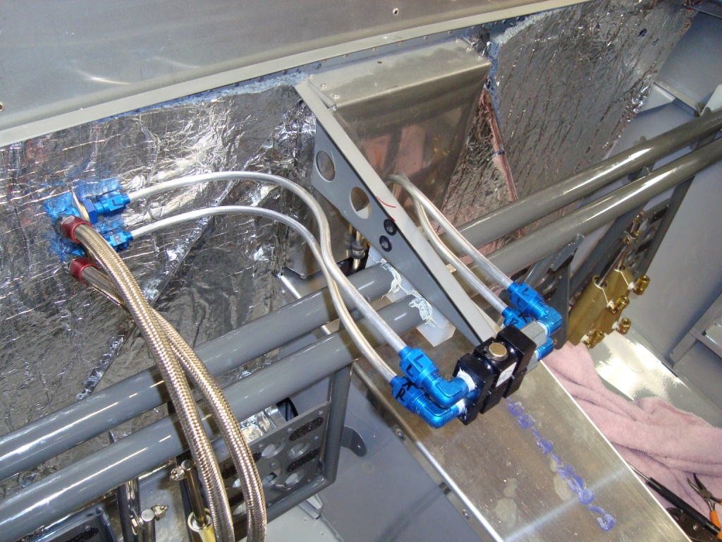

PostPosted: Sat Sep 29, 2012 9:50 am    Post subject: Extras in Fuselage Reply with quote
A couple photos attached on wire conduit and parking brake.  Note – the parking brake is attached to the bulkhead that is not in place in this photo.
Carl

Some thoughts:
<![if !supportLists]>- <![endif]>I used the Van’s parking brake and recommend it. I mounted it under the bulkhead between the panel and firewall so that a reach under the panel provides access. I did not use the Van’s Parking Brake Install Kit as there is no need for a control cable as you move the park lever by hand. This provides a simple but effective arrangement.
<![if !supportLists]>- <![endif]>I put in 6 wire conduits, three running down each side of the fuselage. I ended up filling 5 of the six. I used the Van’s 1” corrugated conduit. I have both EFIS modules mounted in the tail cone (thus you add pitot, static and AOA tubing runs) and an independent two battery electrical system.
<![if !supportLists]>- <![endif]>Antennas must be accessible when done. I mounted both communication antennas under the tunnel, one forward of the other but both aft of the fwd bell crank. The transponder is under the passenger seat and I’ll mount the ADSB antenna under the pilot seat. The nav/ILS antenna is homebrew and mounted in the wingtip. ELT antenna is under the empennage fairing. All antennas perform well. Strongly recommend you defer the fuselage antenna mount site selections until after you first fit up of control surface push tubes and such. This will tell you where you can and cannot mount the antennas. For paint I just put a piece of masking tape on the inside, then did the final antenna mount after paint. Antenna doubler plates of course were riveted before paint.
<![if !supportLists]>- <![endif]>I did not install the stall warning and glassed over the associated wing slot. Two reasons – the Dynon SkyView has a very effective AOA system with audio warning, and over 10 years flying the 8A without a stall warning and never finding the need for one as the airplane itself provides a lot of stall warning.
Carl

Full Disclosure - I have a parking brake and had one on my Maule.  I like it on the '10 after the  leak was fixed.
A parking brake is just a tool, an accessory.  Differential braking is a requirement, a parking brake is optional.   A parking brake can leak, possibly fail, possibly cause future failures, it has weight, it can be misused.
Without it, you may not park in a certain place or you may re-orient the plane.  You'll probably carry chocks.  In any case you will easily work around not having it.  No problem.
With it, you can use it to encourage the plane not to move in certain situations.  You can generally leave the chocks at home.  You'll use it a lot when you don't need it.  It may save your bacon one day but probably not.  It is just a convenience.  It may cause you to cancel a flight because it malfunctions in some way.
It's like GPS or cockpit weather - we flew with out that stuff but we can do more with that stuff.  Actually it's not like either of them because a parking brake isn't going to enable any flights you wouldn't otherwise make.  It doesn't really make anything safer.  It's just a convenience.  More than a cup holder, much less than a tow bar.
I was thinking about how one should decide what accessories to put in and which ones to leave out.  I like all the ones I have.  I don't need any of the ones I didn't put in.  So much for that decision process.

I’d turn the plane sideways under power and/or taxi it to some place where I can plant a wheel where it won’t be as likely to roll (grass or what have you).  I recall needing the inop parking brake in my Cessna once in 600 or so hours.  I don’t recall what I did though when needing it though so it must have been a non event.  I would definitely use a parking brake in the 10 if installed but I chose not to install one in my in progress kit.
