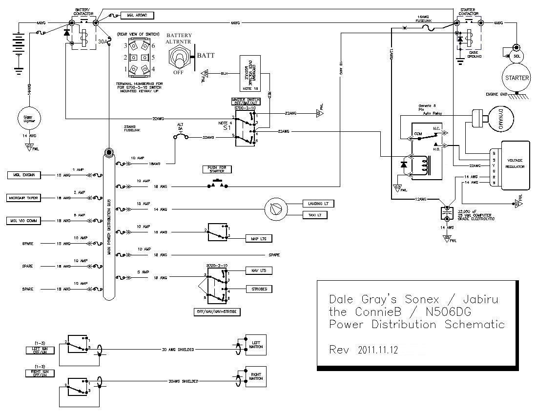

Need some help. First please understand that electricity is NOT my bag! I have read Bob Knuckolls book, I just wish I understood it!
I have a Sonex with a Jabiru 3300 engine. I see voltages ranging from 12.3 at idle to over 16 volts at climb power! I talked with Jabiru and they suggested I change the yellow wire from the voltage regulator (control voltage) to the main bus from the + side of the capacitor (see attached schematic) to read "cleaner" voltage. I did this and I now get voltages of 16 volts at cruise power! I have installed Bob Knuckolls "crowbar over voltage" circuit from B&C. I have never tripped the over voltage circuit (5A C/B) BUT, I have blown the 10A fuse (twice) in the master switch circuit. I reads the voltage in 3 places, the MGL Enigma EFIS, the MGL V10 Comm radio and the MicroAir Transponder....they all read the same. I do NOT have an ammeter. BTW, I can control the voltage by turning on the landing lights. Then I get about 12.6v at climb power.
I read the Jabiru manual and it tells me the voltage regulator should output 14 + or - .8 volts at cruise power. Is my schematic correct or do I have an error??? I think I have a bad voltage regulator. I have 18.3 hours of time in the phase 1 testing.
Thanks in advance.

PostPosted: Tue Nov 15, 2011 5:44 pm    Post subject: Jabiru 3300 Over Voltage Reply with quote
These small alternators produce no useable power
at idle. Hence your 12.3 reading is what the BATTERY
is supplying.
If you EVER have 16 volts, the regualtor is not doing
it's job either because it is bad . . . or wired wrong.
Okay, my best guess is that the rectifier/regulator is
bad.
You need to look at the diagram in the 'Connection
again. That's NOT a 10A fuse upstream of the 5A breaker
but a fusible link. A 10A fuse will open faster than
a 5A breaker when the crowbar module trips. So, if
you've popped some fuses, the OVM is on confirming what
your voltmeter has already told you. The factory
adjusted trip point for the 14V OVM is 16.4 volts.
They must be working.
Don't need one.
That's probably because you've depressed the system
voltage by overloading the alternator.
I think so too. You perhaps understand more than
you think!
ainut(at)knology.net

First, suspect the voltmeter. Get a (calibrated) second meter and check
it out. Easy to do that.
Ammeters are cheap. Please install one, at least temporarily until this
problem is solved.
It does sound as if the voltage regulator is not cooperating fully.
simple, but that is all I know is simple stuff.

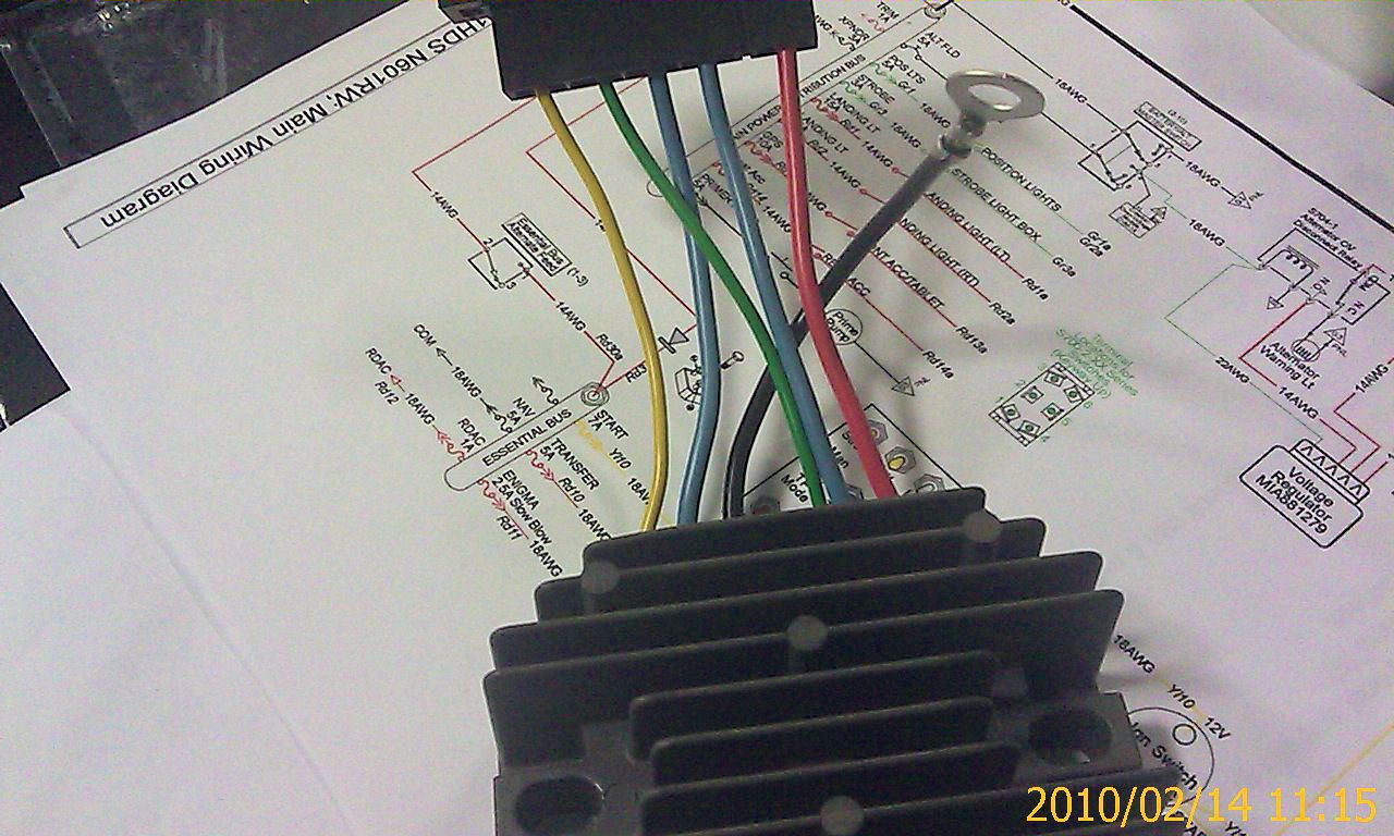

Thanks for the response Bob. I know I'm getting an over voltage event because is trips the 5 amp breaker in the over voltage circuit and it's hot to the touch, plus I can see the voltage increase on the EFIS most of the time, otherwise reviewing the recorded EFIS data (1 second increments)
This happened once early in phase 1 but has progressed to where it will happen multiple times per flight now. If I keep the landing lights on I can prevent the event.
One curious change, it used to take a few minutes for the breaker to cool off before it would reset. Since I moved the yellow IGN wire from the OV relay to the battery positive terminal when the voltage increases and trips the OMV I can toggle the alternator switch and immediately bring the alternator back online.
I have replaced the OVM14 and the voltage regulator and haven't eliminated the problem. Any help would be appreciated.

Make sure all connections are clean and tight between the main bus and the voltage sense terminal of the voltage regulator. Make sure the regulator is well grounded.
I suggest monitoring the voltage between the voltage regulator metal case and the 18awg yellow voltage-sense wire where it connects to the regulator. If that voltage goes above 14.5 volts, then replace the voltage regulator, regardless if it is new or not.
Joe

Need to see your wiring diagram along with a narrative
of voltages you're observing during 'normal' or 'trip
free' operations.

PostPosted: Mon Mar 12, 2012 5:37 pm    Post subject: Re: Jabiru 3300 Over Voltage Reply with quote
Bob my wiring diagram is attached to my message about 3 above this one. I've attached a chart of of two flights, one about a year ago where you can see a pretty steady 14 volts and a more recent flight where you see the very fast spikes to 15 plus volts. Other charts/datasets show spikes up to 16 volts and a more drastic swings. Hope this helps.

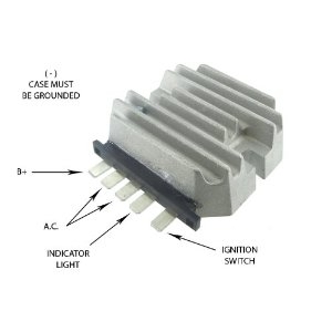

Joe,
All the references I could find, including the link
cited above, gives this order and labeling for
the terminals on a John Deere A101406 rectifier/
regulator. The circuit breaker carries relay coil
current which is independent of any characteristics
of the alternator.
[img]cid:7.1.0.9.0.20120313184945.01df0700(at)aeroelectric.com.0[/img]
Have you seen any data source that argues with
what's shown above?
 Filesize:  21.56 KB
 Viewed:  40747 Time(s)

PostPosted: Tue Mar 13, 2012 4:35 pm    Post subject: Re: Jabiru 3300 Over Voltage Reply with quote
Joe the original regulator was a MIA881279, the replacement I used is the older style AM101406 as shown in your link and yes they wire differently (see attachment). Also the drawing didn't represent the actual wire positions but was drawn for clarity.
The L terminal is going to the light which does illuminate when the relay opens. The Ign terminal is going straight to the battery + terminal right now to eliminate any potential issues in that circuit. Alternator is across the AC terminals with the relay in one leg.
 Filesize:  227.63 KB
 Viewed:  40745 Time(s)

user9253
Joined: 28 Mar 2008
Posts: 1978
Location: Riley TWP Michigan
PostPosted: Tue Mar 13, 2012 6:37 pm    Post subject: Re: Jabiru 3300 Over Voltage Reply with quote
Have you seen any data source that argues with what's shown above?
No, I was going by Rich's schematic that shows the lamp connected to the outside terminal of the voltage regulator. But now Rich has explained that his drawing is a schematic and not a wiring diagram. He is confident that the voltage regulator is wired correctly. I believe him.
I see 3 possible causes for the high voltage:
1. There is a wiring error.
2. There is an intermittent high resistance connection between the main bus and the ignition terminal of the regulator, or between regulator ground and aircraft ground.
3. The voltage regulator is bad.
_
Due to the fact that the 5amp circuit breaker gets warm, I suspect the voltage regulator is bad. It seems to me that the voltage between the regulator ground terminal and the regulator voltage-sense terminal should never go above the set point (14.2). If it does, then the regulator is not doing its job, regardless of any loose connections elsewhere.
The voltage is still too high, even with the voltage-sense wire connected directly to the battery. That eliminates the circuit breaker and the master switch as potential problems.
Bob, please correct me if my reasoning is faulty. Just do not tell my wife that I made a mistake. Very Happy
