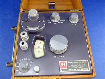

Exactly. I've often thought that we should perhaps
forsake the term "cold junction" for "reference junction".
Classically, the reference junction was any point in the
system where the transition from thermocouple alloys
and instrumentation was known with accuracy. It could
be hotter or colder than the temperature of interest.
I recall the first thermocouple array I ever saw installed on
a flight test airplane at Cessna. The reference junction
for perhaps a dozen switched thermocouples was submerged
in a Thermos bottle filled with crushed ice made with
distilled water. Pretty durn close to 0 degrees C.
But the self powered instruments couldn't be fitted with
ice baths so an alternative reference junction compensation
scheme had to be crafted. I've been meaning to dig through
the old patents someday and see what the popular techniques
were 70 years ago. In that test setup, a flight test technician
had to measure each thermocouple one at a time using a precision
potentiometer bridge in his lap. The millivolt readings were
written to a test data sheet and converted to temperatures
later when he wrote his test report.
Tedious . . .

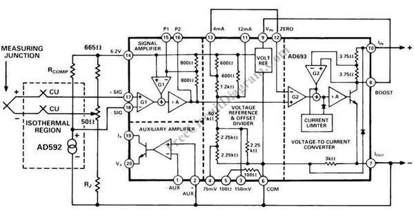

A modern incarnation for implementing a reference junction
is illustrated here:
[img]cid:7.1.0.9.0.20120204100504.01e3b368(at)aeroelectric.com.3[/img]
I think this is out of an analog devices AppNote illustrating how
an AD592 temperature sensor is situated in thermal proximity to a T/C-to-Copper
reference junction. Thus, while the "reference" can be wandering around
with ambient temperature, it's effect on output is known and
compensated for. Even this technique is outdated since Analog Devices
and others have created thermocouple conditioner chips that feature
built in reference junction sensing features and offer user friendly
10 mv/degree output signals.
