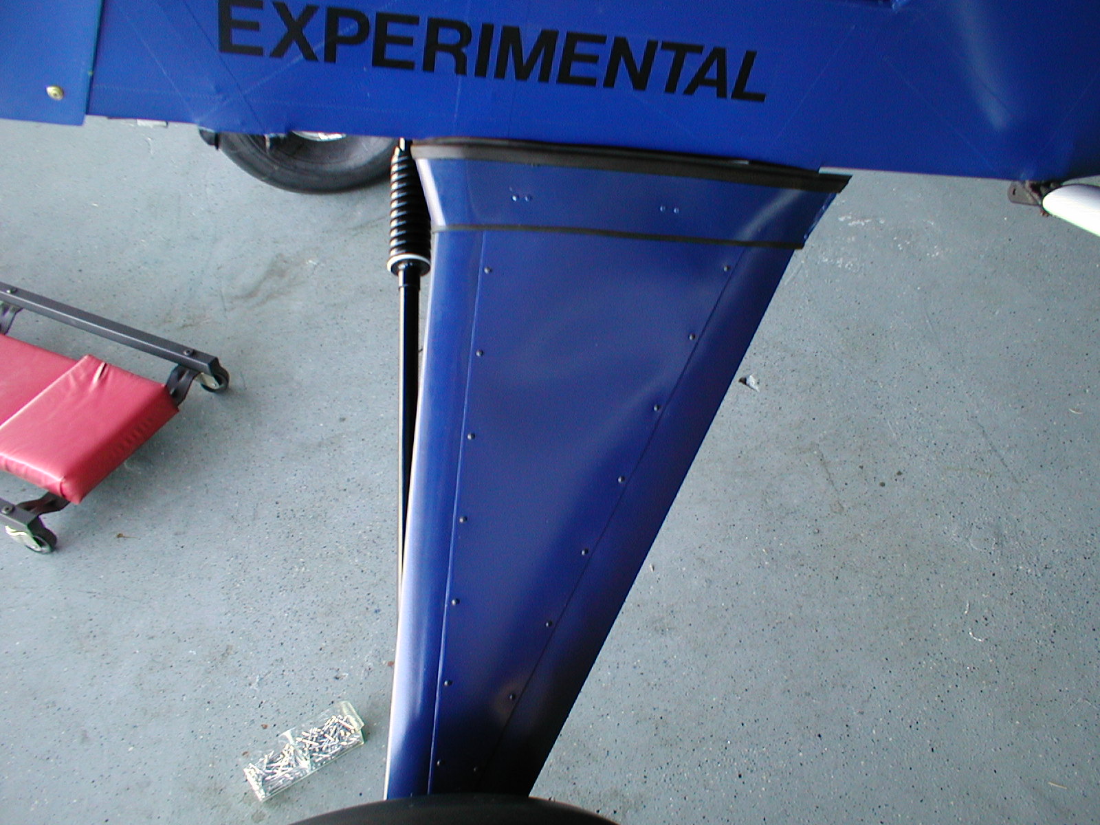

Rawheels,
You could do this for your bush gear.

Dick,
I have always just planned on using wood & fabric like my original gear, so I didn't go for the fairing option on the Highwing, LLC gear. That means I don't have the welded tabs. I could ask Lowell if there is another way to attach their fairings. Sure do like their workmanship. Although, I'd still be looking at trying to streamline a portion of the spring tube that doesn't get covered by their fairing.

The formed fairings need the tabs. The original idea for these fairings was
something that was fairly easily replaceable in the event of damage as they
are right below the doors. Wood and fabric is what I had on my original
bungee gear and it seemed to work fine.

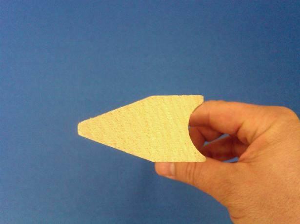

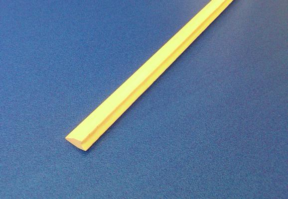

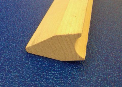

Just wanted to give a quick user report.
Airdale does carry the wood streamlined strips (at) $2/ft. Brett was very easy to work with, and the test pieces I ordered were delivered quickly.
I've attached some photos of the product. There are a few observations that probably need to be pointed out about them if someone else is looking at ordering some for their project.
1. As shown in the photos, the shape of the pieces aren't really "streamlined"; your buying a 1x2 with a couple of angled table saw cuts and a pass across a router. So, don't expect a lot for the low price.
2. The piece feels pretty heavy (at) 1.2 lbs for a 3' section (I'm assuming it is pine). This might hold up better on the back edge of my landing gear, but that could add up if you were doing struts. With Balsa (at) ~$18 for a 2x4x36 board from ACS, you could make some lighter ones for about the same price if you have the tools already.
3. The strips will make the tubes more streamlined, but they fall short of the desired 4:1 teardrop shape. When attached to a 1" tube the overall length is a little shorter than 2.75". That is about the same size as on my old landing gear, and will work for my purpose, but may not be desirable for others.
Ryan

Kitfoxers, Try western red cedar, It's lighter than pine (not balsa wood light), readily available in tapered cross section as beveled cedar siding, easy to machine, and reasonably priced. If you haven't got a table or bench saw and hand plane to finish it up, you probably belong in a certified airplane.
