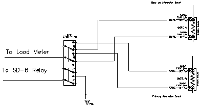

I have an SD-8 auxiliary alternator. I am using the Z-13 wiring scheme which has shunts for the primary and auxiliary alternator. I will be using a Dynon EMS. The Dynon has a single input for ammeter. I want to access the both shunts in the Z-13 wiring scheme. My initial design was to use a DPDT relay connected to the auxiliary alternator switch. With the switch in the off position, the primary alternator shunt would be connected to the EMS. With the switch in the on position the relay would disconnect the primary and connect the auxiliary alternator shunt.
Question: Is a simpler alternative to hook both shunts to the single EMS input? And if I did this, would the reading be the sum of the two, if both alternators were active at the same time?

Do not connect the two shunts in parallel. Doing that is the same as connecting the two alternators in parallel. The Dynon would read the higher of the two voltages, not the sum. Using a relay will work.

I was planning to use a separate dpdt switch on the instrument panel, but I like the relay idea.  Which relay were you planning to use?
Joe
Right on. I'll also suggest that unless the
relay is really desirable from the perspective
of reducing numbers of wires at the panel controls
you might consider using just a DPDT switch
as shown on the third page of:
http://www.aeroelectric.com/Catalog/AEC/9007/AEC9007-700.pdf

I thought about the using the switch directly and may still do that. Using
the relay tied to the switch for the auxiliary alternator set it up so the
shunt selection would occur when the auxiliary alternator was turned on,
eliminating the need to toggle two switches.

So use a 3PDT switch for turning on the aux alternator. One pole switches the alternator on/off the other two switch the shunts. ????????

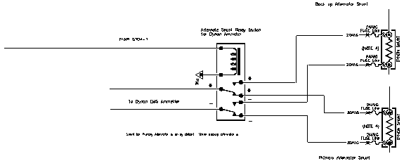

Like this:
I tend to have a habit of taking the long way around the bush.

John;
The drawing is a little small to see the detail clearly but……….
Yes, I think you’ve got it. (you’ve depicted a four pole switch, one pole of which you aren’t using which is fine.)
You need a second wire to your load meter from the upper pole of the switch to complete the shunt circuit.
The progressive transfer feature which I think you’ve depicted on the upper two poles isn’t needed.
The switch need be only two position double throw, without a centre off position which it appears you’ve drawn.
But yes, this is basically correct without nitpicking the drawing details which are waaay superior to anything I could come up with.JJJ

Thank you for the feedback. I did leave off the one wire for the load meter. I’ll take a look at the “book” and make sure I order the correct switch for the job.
