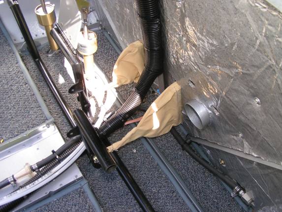

PostPosted: Thu Jul 15, 2010 7:47 am    Post subject: Re: Firewall Steering rod holes Reply with quote
Hi Roger:
It IS a firewall, and I just don't think the rubber boots that people are using fit the purpose, other than keeping out air and exhaust.
I made some nomex boots, and just in case they weren't airtight enough (which I think they were) I coated the inside with "tent sure" (a urethane paint made for sealing tents). This is a picture from my 601 which has been sold.........Fred Sanford N9701

PostPosted: Thu Jul 15, 2010 8:53 am    Post subject: Firewall Steering rod holes Reply with quote
True statement Fred. My concern was carbon monoxide poisoning. Fire is a
whole different story......Ralph Sharp N701SA
