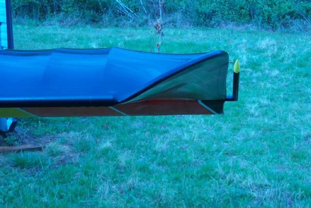

I did - to 26'9" - I'll send some pictures. I think it works fine. I have standard Kolb Ribs (built on a wooden jig - the old fashion way) - different wing bow ...a few other things different but not with the wings though - execpt VGs.
