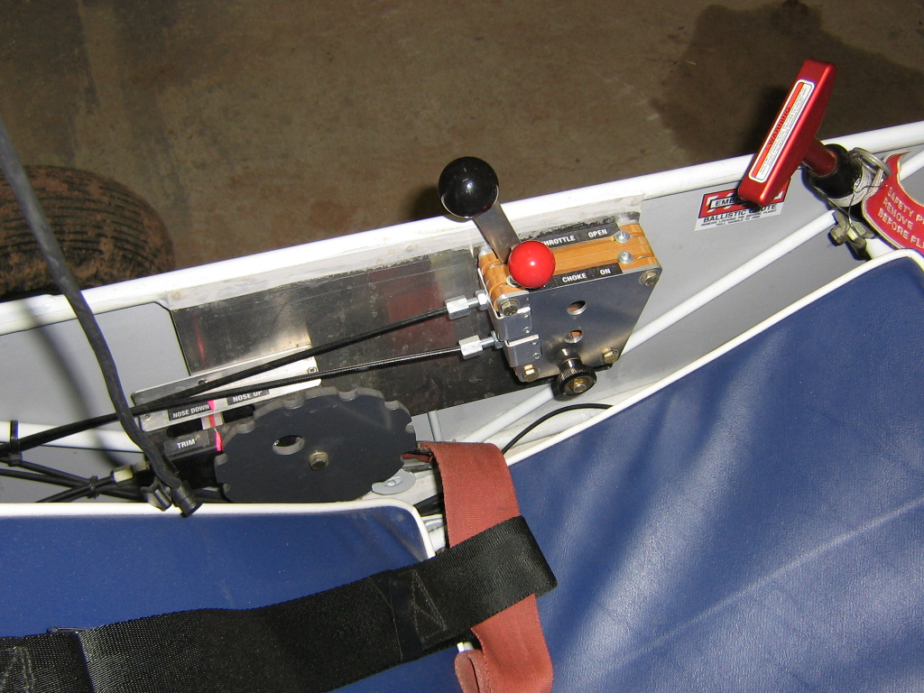

I installed in flight trim wheel from Rans, works great. here is a photo. Brian.

PostPosted: Sun Feb 21, 2010 6:37 am    Post subject: In flight Adjustable Trim Reply with quote
I purchased one of them a while ago and built it into my panel I wasn't happy with it , it is two slow moving & not enough travel you could never land with it if you ever had an elevator cable break unless you had a two mile runway and 800 mile aproach , so I built a new panel and am working on another set up
Ellery Batchelder Jr.
elleryweld(at)aol.com
PostPosted: Sun Feb 21, 2010 6:43 am    Post subject: In flight Adjustable Trim Reply with quote
anyone need a trim wheel setup  like Brian's that fits a Rans I have one to get rid of it works good but not to my satisfaction
