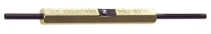

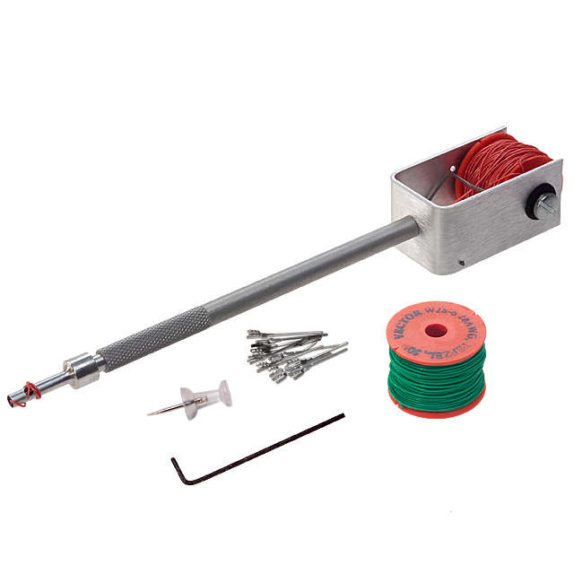

Already had a comment on the analysis . . . someone noted that
the terminals around which the coil wires are wrapped are square
and may indeed have sharp corners.
He reminded me of an arcane point-to-point wiring process
for complex digital circuits called "wire wrap". This
process used special wire, tools, sharp edged square terminal
posts and no solder. The tools were designed to tightly
wrap the wire around the post with enough turns, and
stretching force to create multiple gas-tight joints
on the corners at each connection.
As I recall this technology called for about 6 tightly
spaced turns around the post (24+ points of contact).
Since this coil-form is plastic . . . and soldering these
joints would call for considerable heat and time,
it may well be that the original design calls for
no solder at all.
In this case, the assembler of the failed item was
perhaps not in possession of the right tool. The turns
about both posts are not those produced by a "wire wrap"
tool. The curious thing is that there is SOME solder
on one of the terminals . . . perhaps didn't pass a
continuity test and the solder dab "fixed it" only to
have the other joint fail later.

PostPosted: Wed Feb 17, 2010 6:48 pm    Post subject: S701 Contactor Failure Analysis Reply with quote
You have a good recollection.
I just did some wire-wrap late last year.
However, the wire used has Kynar or other insulation that is removed to expose a bare, generally tin coated, conductor.
The wire used to wind the coil, from your pictures, appears to be 'magnet' wire which has an insulating coating. The wire-wrap process, as I have always seen it implemented, is not designed for this type of insulated wire and is not expected to breech the insulation to form a contact.
I believe your original diagnosis of no solder was spot-on.
Ron Q.

PostPosted: Wed Feb 17, 2010 8:13 pm    Post subject: S701 Contactor Failure Analysis Reply with quote
Your recollection is generally true and the same as the wire I have used
for all the wire wrapping I have done. However, once upon a time there
was wire sold for wrapping that did not require stripping.
Unfortunately, I don't remember who sold it nor do I have any. Further,
I seem to recall that it was not too successful as it eventually tended
to short anywhere it overlapped under tension.
The wire on the teardown certainly looks like common magnet wire. And
in any case, three or four turns would certainly not be sufficient to
make long term reliable contact in something like this which is likely
to be exposed to rather harsh environmental conditions. I agree with
Bob that they just forgot to solder the wires - the operator probably
got interrupted during assembly.
Dick Tasker
contact.
Ron Q.

PostPosted: Wed Feb 17, 2010 9:33 pm    Post subject: S701 Contactor Failure Analysis Reply with quote
At 10:22 PM 2/17/2010, you wrote:
I'm feeling old... My only hands-on experimental
circuit making was pre-digital. Â Over the
years I'd pickup electronics mags and see
references to "wire wrapped" terminals and never
had a clue what it referred to. Â Now I get it... Thanks.
Bill
see:
http://en.wikipedia.org/wiki/Wire_wrap
This is the modern incarnation used on complex backplanes
where gazillion-layer boards are impractical. The no-strip
version is from way-back-when and it didn't hang around
long.

PostPosted: Thu Feb 18, 2010 7:41 am    Post subject: S701 Contactor Failure Analysis Reply with quote
I remember using the "no strip" technique many years ago. As I recall,
the wrap tool did slit the insulation as it was wrapped around the
post so that bare wire was wrapped onto the post.
Bob W.

OK, I got curious. You can still buy the thing from Digikey:
http://parts.digikey.com/1/parts/996077-tool-slit-n-wrap-manual-w-28-p184-1.html
I can't believe they are charging $232 for one of those things. I'm
sure I didn't pay anything like that. I might even be able to find my
old one if anybody want a real deal. Smile
Bob W.

PostPosted: Thu Feb 18, 2010 2:00 pm    Post subject: S701 Contactor Failure Analysis Reply with quote
Yeah, I know. I recently looked to see if the OK Industry wrap/strip/unwrap tool I have was still available. My jaw dropped when I found out the answer is yes and it costs $34.33 from Digikey!
[img]cid:part1.07050000.06080202(at)optonline.net[/img]
