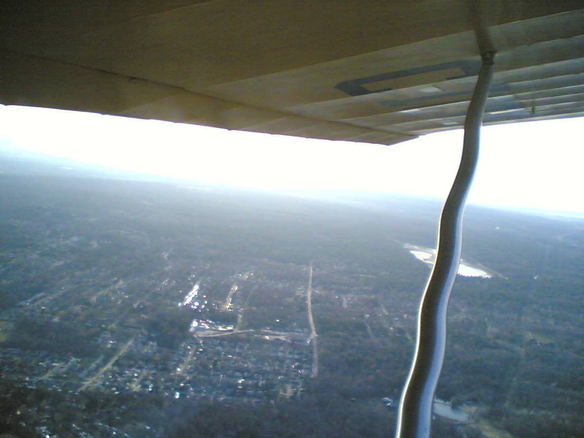

I have often noticed some vibration of the wing struts of my Twinstar MK II .
This happens at a given RPM when the strut seems to hit a "resonance" point and start to vibrate. This never bothered me too much as it seems to only happens at a RPM of around 4500 .
Now ... i took some picture with my camera phone while flying yesterday
that happens to "catch " these vibrations on the picture.
I have been quite surprised when i saw that picture with the apparently quite large amplitude of the vibration ! Quite amazing ... but it could also be
an optical "effect" created or amplified by the relatively low shutter speed of the camera ...
In any case i am now thinking of installing wing strut fairings to try tio fix the "problem" .
I have seen some modular plastic fairing that can easily be installed on a Rans S-12 (i think) ... These are made of 2 plastic parts that "snap" together to form a "water drop" shaped fairing ...
Any one could submit a source for these ?
Good and safle flying to all ...

In a message dated 4/15/2006 2:44:16 PM Eastern Standard Time,
noel(at)teledata.qc.ca writes:
fix the "problem" .
My '04 and 503 powered Firestar II does the same thing depending on how the
503 feels like eating it's oats. I have the strut fairings too...same deal. I
let the sumbitch vibrate. If the strut fails, I got the 'chute.
Wild Bill Catalina

Noel,
Look's as though the strut is distorted from your lexan being photographed
through, you do have a canopy on right. Look at the landscape you will see
your straight lines are distorted also. Just my guess though.
Bob D.
