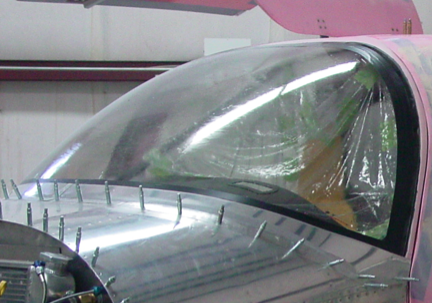

PostPosted: Mon Feb 08, 2010 11:17 am    Post subject: Re: Windshield fairing Reply with quote
I went with the aluminum fairing from M.L.Skunkworks. Worked out great.
John
 Filesize:  229.89 KB
 Viewed:  11205 Time(s)

PostPosted: Mon Feb 08, 2010 2:51 pm    Post subject: Windshield fairing Reply with quote
I really do think having those videos are a great reference, I liked your presentation and based on the feedback I heard from a couple builders who came to your class it shows you do an excellent job explaining how to do these things.
As a reference for many I use those hotel cards, the ones one gets for the doors, and use them for spreading out the resin over the cloth the good thing about this is once they get dirty, which shouldn't be too often if one uses plastic to sandwich the cloth/resin, it can be tossed. I also so a whole lot of the spreaders at HF for a few dollars so certainly a great suggestion Dave makes about using them.
Thanks Dave!
Pascal

Sure, that would be great. Let EAA know you want to see more and maybe we can arrange a complete video. We did that while we were at AirVenture. They had a professional studio set up in a workshop and they were making several videos every day.
The technique with the plastic shown in the video would work fine on the windscreen. It makes things a lot neater. There's no reason you couldn't do a couple layers at a time in one sandwich. Or, if it's fairly cool in the shop, say, 60 or below, you could make a large section of sandwich and then cut your strips out of the sandwich. But it has to be pretty cool cuz it's a lot of resin to have laid out at one time. If it's too warm it might start to set up. The windscreen fairing takes several hours, and it's good to have some extra hands available. The strips are pretty long and can get kind of unruly. But the plastic makes it much easier.
(video on sandwich method here: http://tinyurl.com/yhe4upe)

PostPosted: Mon Feb 08, 2010 3:15 pm    Post subject: Windshield fairing Reply with quote
We use a very thin painter's plastic:
http://www.acehardware.com/product/index.jsp?productId=1279480
That's a big box and it would last a LONG time.  Just about any kind of plastic drop cloth would work.  The plastic in the video was much thicker than what we normally use, and it was still easy to work with.
