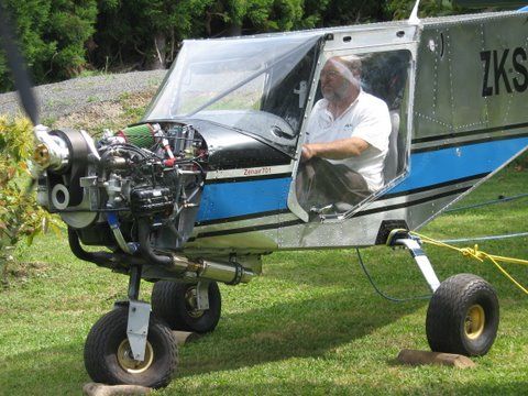

Hi Ross,
Not sure of your configuration, but you might put the radiator back
under the belly a ways and move the 18 lbs or so that far to improve
your center of gravity.
I've attached a picture of an installation that does exactly that, tho
he's not using a Subaru, the installation is clearly the same for 601 or
701 with an EA-81.
My site shows the installation of this radiator on my engine page.
See attached image too.

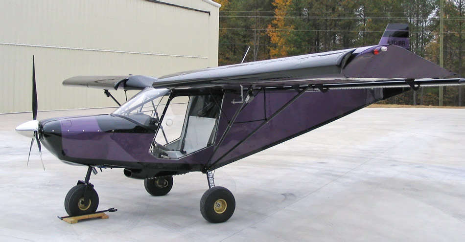

Some pre painting photos that'll show the layout... Thanks for the elevator info John..

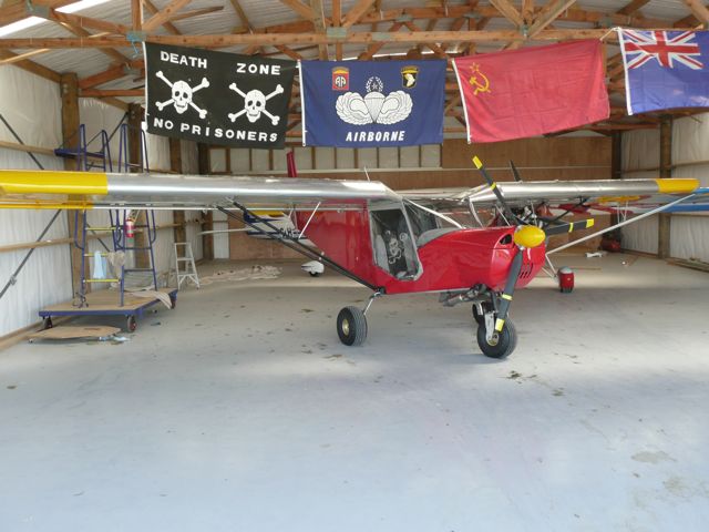

and some more....

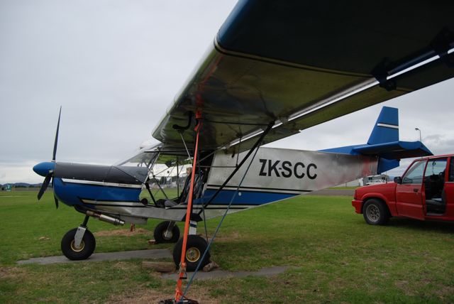

and now
