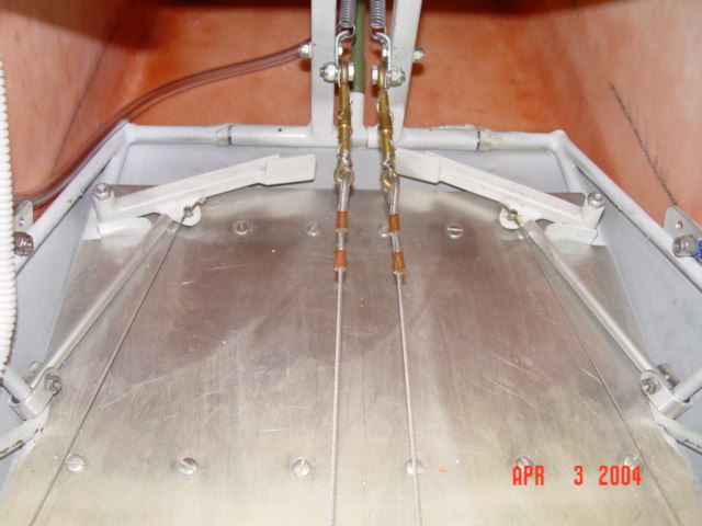

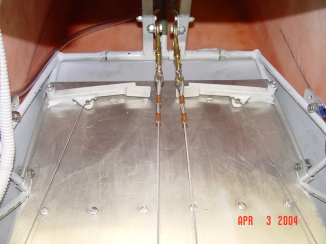

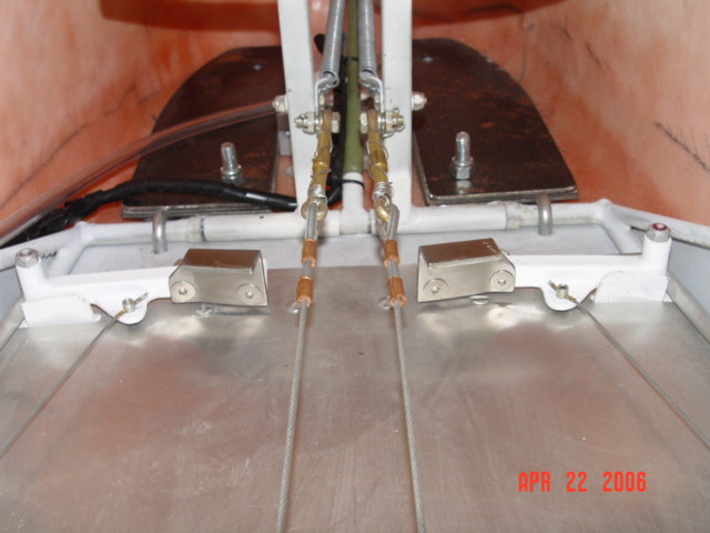

I made toe brakes for my Cables... But the pressure was too much on the Rudder, so I scrapped the whole idea...
And I made Heel Brakes..... I didn't like how low they were,
So I made some extensions that are easy to push....
I'll also put a picture of my Emergency brake set-up
that works with Cable Brakes....
One in the "Stowed" position... and one "Applied"
Gotta Fly...
