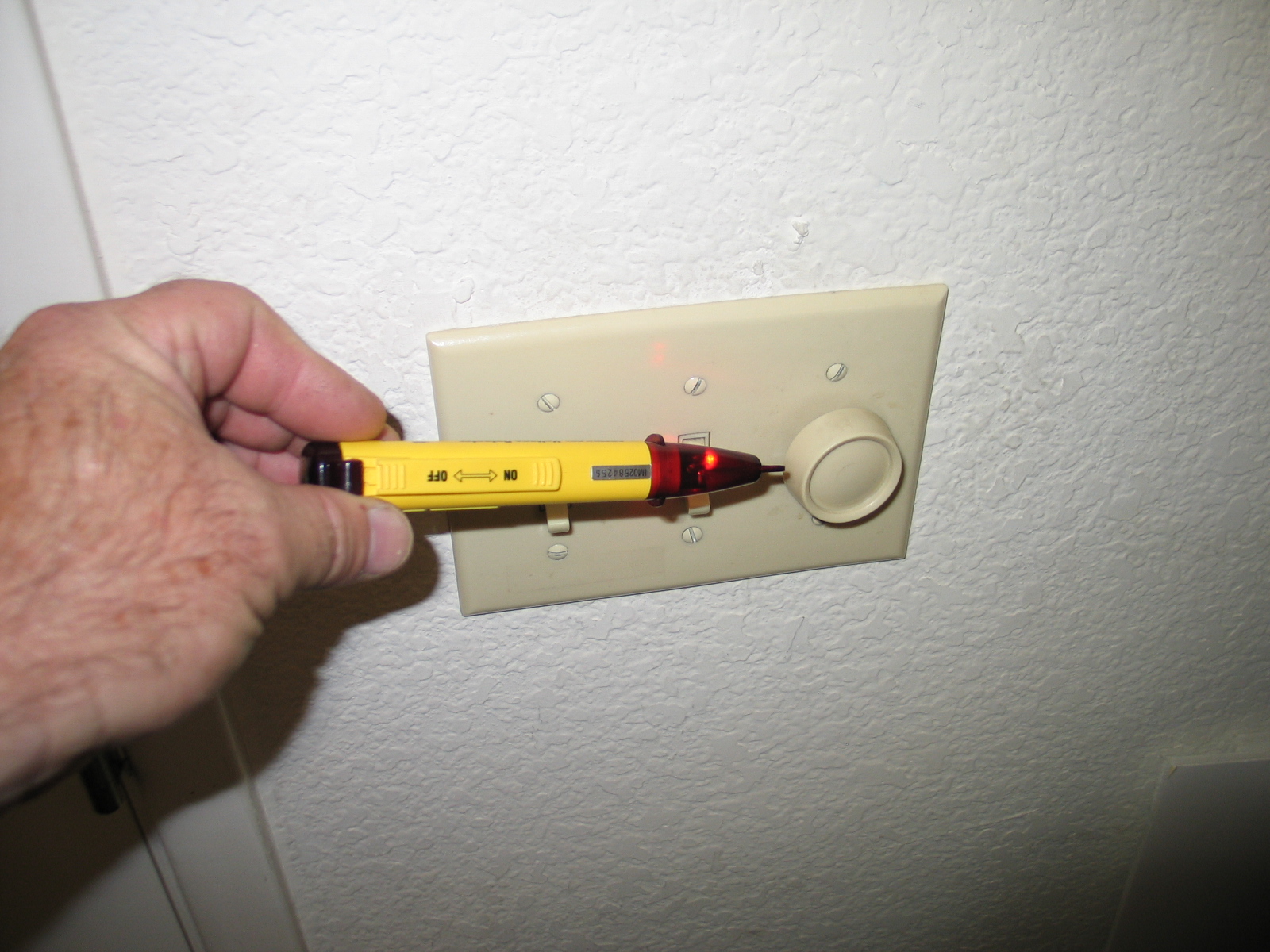

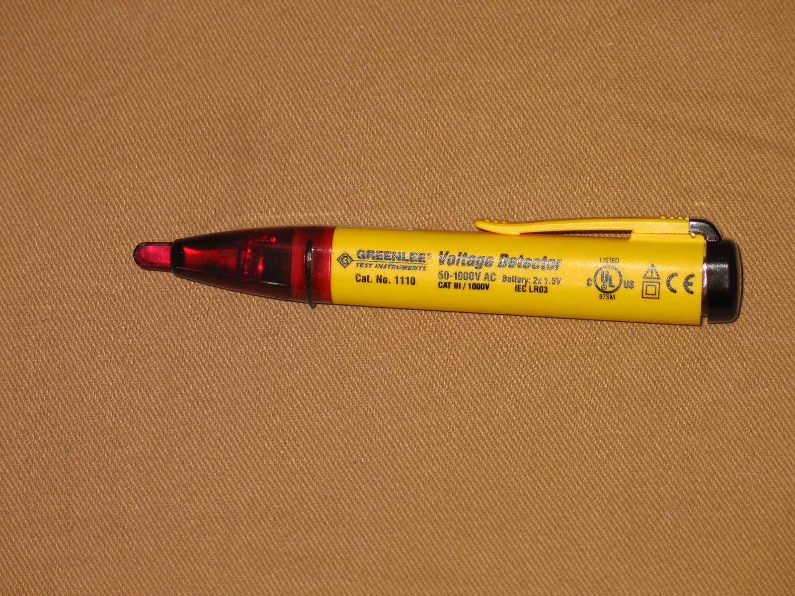

Use this type of 120V AC circuit tester and you can track down a bad plug or wire right up to the coils in a matter of minutes. With the engine running you run the tester along the plug wires and it lights up, if you have a bad plug or wire it blinks erratically or quits flashing.

I really appreciate the suggestion. Sounds like a great way to check the ignition integrity without risking damage. I'll let you know what I find.

I have used it numerous times. You can pin point a bad wire or plug. Makes finding anything from the plug back to the coil easy.
