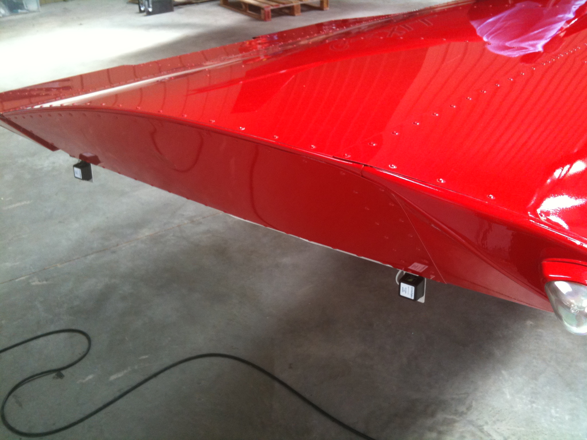

The LAA have started flight testing a 601XL modified with internal aileron mass balances and beefed up spar carry through.
It is fitted with two accelerometers on each wingtip and a gps gizmo data logger installed.
A series of flights have been carried out over two days and after each flight, data from the logger was downloaded to a laptop for analysis.
One more days flying should hopefully complete the programe, possibly later this week.
Photo of wingtip as attachement.
 Filesize:  1019.13 KB
 Viewed:  7243 Time(s)

Do you have anymore information on the aileron changes? The picture looks like there are two ailerons. Jerry of GA DO NOT ARCHIVE

It'a a standard aileron with another rib attached where you can see the double row of rivets as extra support for the arm which protrudes forward into the wing with a balance weight on the end. Very neat and unobtrusive.

I believe that the counterbalance design being used by the LAA is very similar to the design shown in Fig. 24 of Prof. Weltin's GVT report.
http://www.zenairulm.com/FAQ/pdfdocs/CH601XL-GVT-June6.pdf
