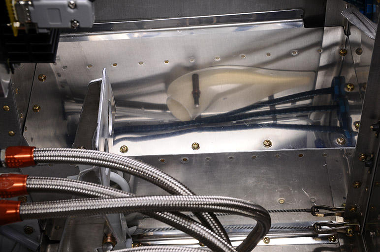

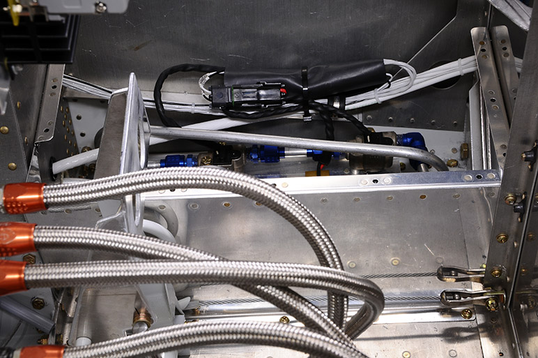

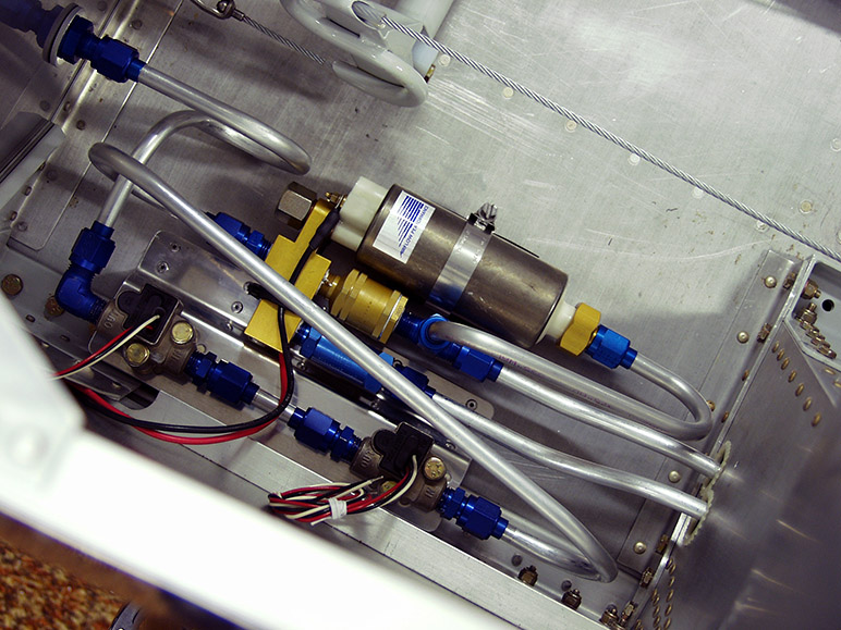

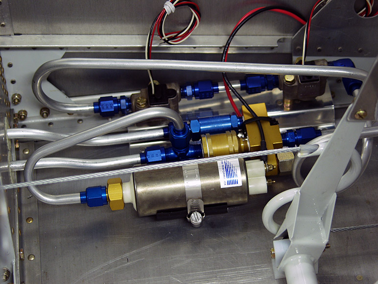

Hi Brian,

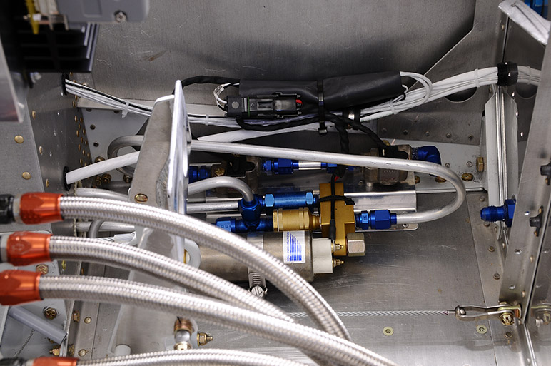

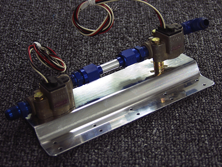

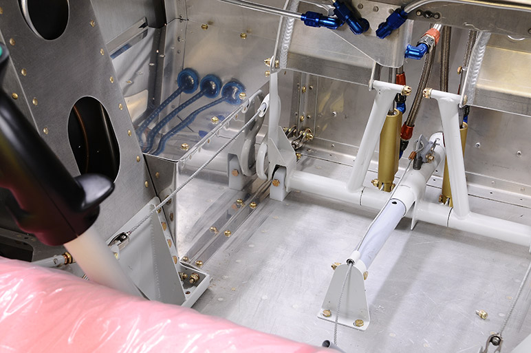

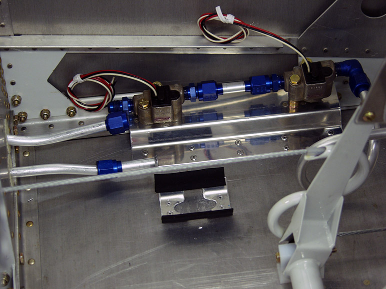

I haven't actually run with this configuration, but attached are some photos of my installation. I have two 201b transducers, one for the GRT EIS4000 and another for the Matronics FuelChec DX. I might have been able to share the signal, but I preferred to just have completely separate units. I put them on the output of the electric fuel pump after a generous length of tubing. I'm running the high-pressure fuel pump for the IO-390 engine. The transducer reading stability is a lot less of an issue on the injected installations.

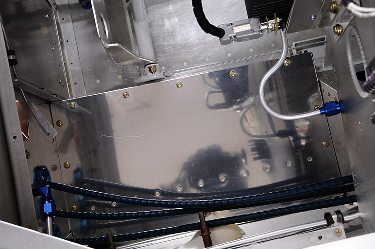

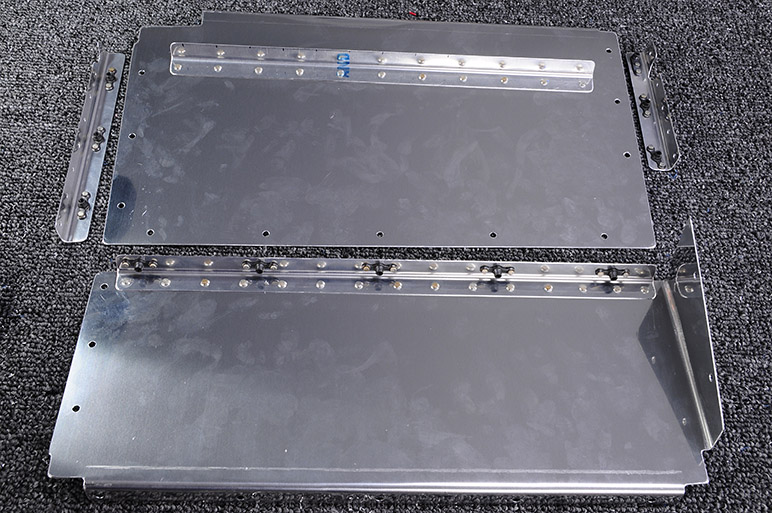

I also built an enclosure around the fuel pump area so that I could carpet over that area.
