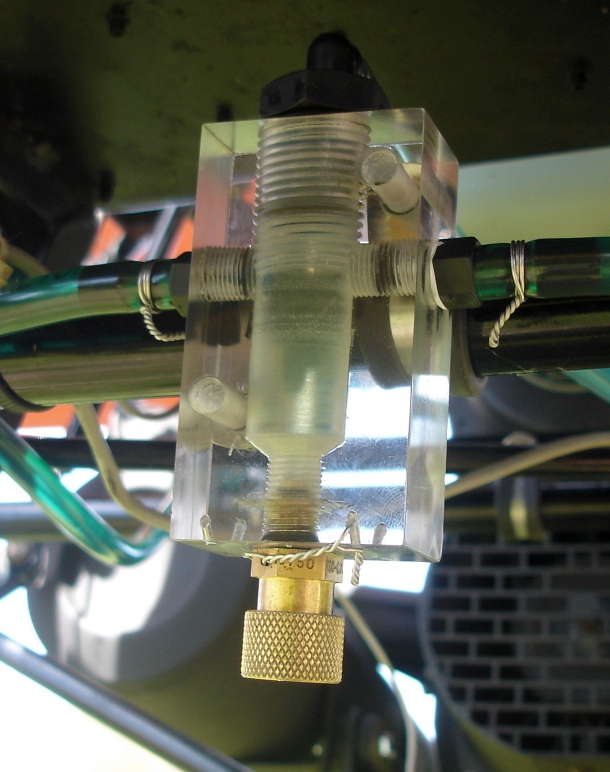

PostPosted: Sun Apr 26, 2009 10:05 am    Post subject: Re: Transparent gascolator with drain valve Reply with quote
Here's the actual installation, on the cross tube under the seat of my UltraStar. No problems, no leaks, no discernable degradation of the plastic so far.
-Dana
