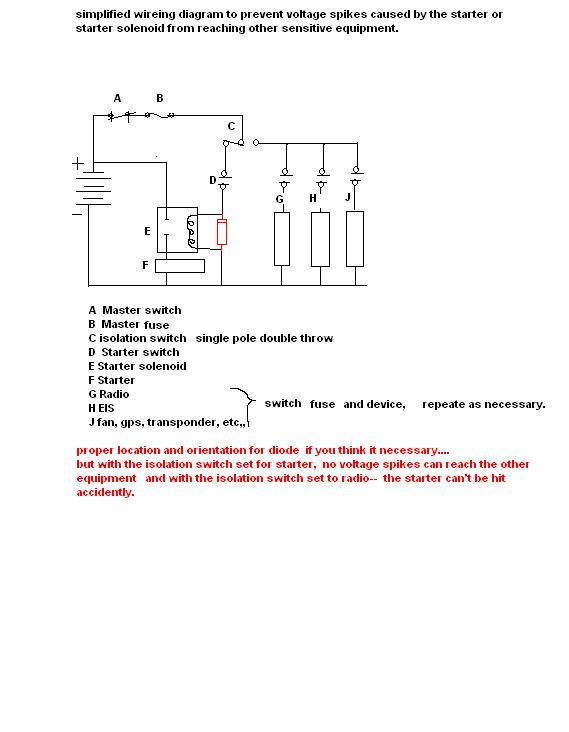

| Quote: | >>>>>>>>>>>>>>>>>>>>>>>>>>>>
Rick
this is how I approached the problem... it seems to be fail safe and easy. I did not use the diode but I showed it in the diagram to show proper placement.
Boyd

rlaird
Joined: 10 Jan 2006 Posts: 373 Location: Houston
Posted: Mon Feb 09, 2009 8:51 am Post subject: diode on a starter solenoid |
So, Boyd, where does the wine chiller plug in?

by0ung(at)brigham.net Guest
Posted: Mon Feb 09, 2009 12:19 pm Post subject: diode on a starter solenoid |
The wine chiller would be item "K" under "repeat as necessary"
I don't have one of those on my kolb, never crossed my mind.
Boyd

Rick Lewis
Joined: 03 Jul 2007 Posts: 122 Location: Kingston, Tn.
Posted: Mon Feb 09, 2009 4:01 pm Post subject: Re: diode on a starter solenoid |
Boyd:
The way you have your system wired is perfect isolation so much so that the diode is not needed at all to protect the electronics. The diode is however still needed to protect the starter switch contacts. The contacts can actually pit without it. Good job, I'll be using your idea in my plane.
