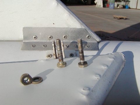

Hi Jimmy,
Thanks for the heads up, found my A3-10 bolts a little worn so I replaced them before I flew yesterday.
Will Uribe
FireStar II
El Paso, TX

PostPosted: Sun Feb 01, 2009 8:31 am    Post subject: Check your Horiz. Stblzr bolts Reply with quote
If these bolts are left loose,vibration makes them spin.Using a spacer on the bolt,if you don't fold it frequently,allows you to put the bolt in very light tension.If you fold it ,you have to be sure the clearances do not change before you add any tension or you introduce bending forces.By shaking it up and down during your preflight check,you can even tell when it wears through the cad plating .

PostPosted: Sun Feb 01, 2009 9:48 am    Post subject: Check your Horiz. Stblzr bolts Reply with quote
zeprep251 C (do you not sign your name?)
You can NOT add a spacer to the forward horizontal stabilizer attach bolts (to put the bolt in very light tension). The entire stabilizer slides forward and backwards every time the elevator is moved up or down. You will break something immediately C if you remove the ability of the stabilizer to slide for and aft.

PostPosted: Sun Feb 01, 2009 4:18 pm    Post subject: Check your Horiz. Stblzr bolts Reply with quote
Sorry Mike,
I used fuel line to space it on the FS. On the MK-3 it's all stainless tabs and it wears the bolt plating before the stainless,but I can put a little tension on the tangs with the nyloc nut.I still lube it and everything else that moves.The tail wheel is the most problem with dirt.

PostPosted: Sun Feb 01, 2009 5:34 pm    Post subject: Check your Horiz. Stblzr bolts Reply with quote
Gary,
As I understood your description of "spacers", I got the impression you might not have been
aware of the stabilizer's fore/aft movement. If you are aware, great. I thought you meant metal sleeves as spacers. This would cause bad juju. (Swahili for "Oh crap!")
Does using fuel line allow for easy lubrication of this attachment point? I guess as long as you completely dissasemble the pieces periodically, and clean any dirt, etc, and then reassemble
all the clean lubed pieces, this would keep the bolts in good condition for a long time.
It has been awhile since I have observed the attach point movement. If I recall correctly, it's about a half an inch. (No, I don't think this qualifies as weight shift.) Will the fuel line compress easily and sufficiently to work okay?

PostPosted: Sun Feb 01, 2009 8:07 pm    Post subject: Check your Horiz. Stblzr bolts Reply with quote
Mike Welch
Mike W:
If the elevator hinge pin and elvator control mechanism are rigged
correctly, there will be no movement in the inboard end of the horizontal
stabilizer. My right horizontal stabilizer doesn't move fore and aft.
However, the left one does about an 1/8 inch at full travel. I couldn't get
two of them the same.
One half inch of fore and aft travel in the inboard end of the horizontal
stabilizer is a tad excessive. As Bob B remarked, "May be bordering on
weight shift."
I think Jimmy Y has a unique problem based on an engine hard mounted to the
airframe.

PostPosted: Mon Feb 02, 2009 6:26 am    Post subject: Check your Horiz. Stblzr bolts Reply with quote
Mike,
Good point.I Never considered that movement,only the folding action.Used the soft yellow 1/4" line,but had to extend the support upward about 1"with 1/8"4130 plates and steel spacers to help the trim.Only used the spacers for a couple hours before modifying the mount.I may have run into trouble if I had kept them in.The MK-3 has stainless brackets and it's easy to tension lightly.I only have wear on the passenger side bolt.I have changed it twice in 200hrs.I thought the higher rpm ,3100,may be rattling things around back there.I can remove almost all the free play with a new bolt.The plating must be softer than the stainless.
  Thanks, G. Aman

PostPosted: Mon Feb 02, 2009 11:34 am    Post subject: Re:Re: Check your Horiz. Stblzr bolts Reply with quote
>>I think Jimmy Y has a unique problem based on an engine hard mounted to the airframe.<<
John,
I do appreciate and have high respect for your input. I'll keep a close eye on my plane for any evidence of vibration problems.
Regarding the grooved bolts I mentioned: Back in late '07, after I had owned the FS for a couple of months, I was rehearsing the fold up procedure and noticed the bottom 3/16" bolt that holds the flying wires was grooved out about the same amount as the ones I replaced last week. At that time, the only engine ever on the plane had been a 503. Since that bolt and the top ones I replaced are castle nutted, and unless they are snugged up a bit tight, they are going to spin. Since it also hapenend to that bolt, that wear pattern can develop with either engine. It could be the spin of the bolts that wore the grooves in both cases, but I don't know for sure.
I'm no vibration expert. I can only go by feel, and I do not feel any more vibration with this engine than I did with the 503. It is a different feel, not the high-frequency vibration the 503 put out, but a lower-level vibration. Makes sense, the RPM's are around 55% of what the 503 turned at cruise. I do not know if that would make a difference with regards to metal fatigue or not, but if anyone knows much about it, feel free to chime in.
I know I am flying a Kolb with a non-typical engine, and there is only one other Kolb I am aware of with the same engine mounted the same way. I don't get to bounce a lot of ideas or experiences off fellow Kolb pilots with the same set-up, so it's a lonely world out here. I'll be a cautious, meticulous PIC and do the best I can. Hope to see you again at Nauga this summer, if not sooner.

PostPosted: Thu Feb 05, 2009 10:59 am    Post subject: Re: Check your Horiz. Stblzr bolts Reply with quote
My horizontal stab front attachment bolts show zero wear after about 200 hours. It is very important for the tail attachment to be able to slide on these bolts, if not the attachment will fatigue due to bending and fail Shocked
I keep this area as well as all other moving areas well greased. Not only do I have zero wear, my flight controls feel like they are on bearings. Someone mentioned the issue of grease attracting dirt, which is not ideal, but this just has not been a problem. Given the reports in this thread, metal to metal wear is a problem and is bad.
So for the grease causing more wear theory, it is just not happening. There is a saying " Results trump theory every time ". I will go with what is actually happening rather than what someone thinks might be a probelm.
